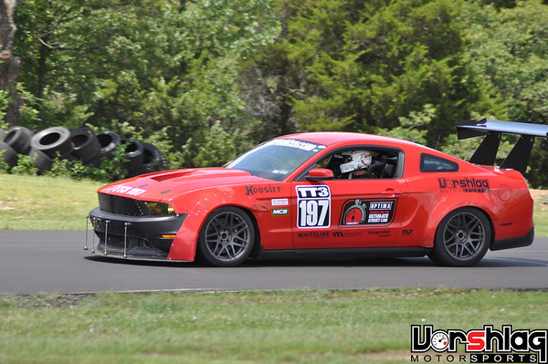

That picture shows a cool suit shirt + cooler + lines. There's also a pump, that circulates the cold water through the shirt, of course. Typically some amount of water is used with a full 8-10 pound bag of ice to keep it COLD.
We have installed these systems for customers with W2W race cars, and they are very popular in endurance race cars.
NASA Time Trial isn't necessarily where you'd use one of these systems, though, and I don't want people reading the advice above to thing that they NEED a cool suit in any way shape or form to do normal HPDE track events or TT. Adding a cool suit is so far down the list of "good safe things to do" it almost doesn't register on the radar for a TT driver. Maybe if you only race in mid-summer in Arizona, and you want to stay out on track for the longest possible time, then.... maybe. These systems add a significant chunk of weight and cost. Drivers are constantly swapping out bags of ice, and if the track doesn't have ice for sale you are pretty much out of luck. I've done multiple endurance races in Texas (with stints ranging from 2-3 hours) and have yet to use a cool suit... but they are popular in that form of racing.
I will not be installing a cool suit system in our TT3 car. Road Atlanta was a complete fluke - I ran stints so uncharacteristically long that my complaints the heat there should be ignored. I did notice 3 TT drivers at the NASA Hallett race (out of 44 TT drivers) this past weekend with cool suit set-ups, but they were driver's in cars that take a LOT of laps (read: not on Hoosier A6 tires) and/or driver's that "double-up" and run TT plus W2W.
This event was hot - 94 degrees and very humid - but the only time I felt any discomfort was when wearing my crappy, heavy, cheap, 3-layer driving suit. I've got to replace this old thing, which is much heavier and hotter than a quality suit would offer. My longest stints were 4 laps, but most of my sessions were 2 laps each. That's how you use a Hoosier A6 competitively, what can I say? We did manage to snag another double TT3 win, reset the track record, and won 4 more tires with a fairly quick overall time (3 seconds quicker than our old lap record from last year). More details coming soon in an event write-up.
