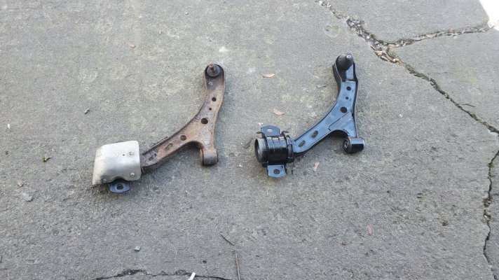

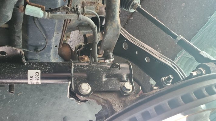

Folks, I wanted to follow up on my removal of the aftermarket performance lowering kit and conversion back to stock ride height. Personal preference is a hot rod look. I went a bit overboard and ended up replacing Rear springs and shocks plus front Struts (with springs) + sway bar links + Control Arms + Inner/Outer Tie rods. The car has 120k miles on it and I figure it could use some new hardware. Here is what I purchased for reference:
Amazon.com: Detroit Axle - Front Struts Coil Spring Sway Bar Links Rear Shock Absorbers Replacement for 2005-2010 Ford Mustang - 6pc Set : Automotive
Amazon.com: Detroit Axle - Front End 10pc Suspension Kit for 2005-2010 Ford Mustang 2006 2007 2008 2009, 2 Lower Control Arms + 2 Sway Bar Links + 4 Inner & Outer Tie Rods + 2 Boots, Replacement : Automotive
Maximum Motorsports Mustang Lower Strut Mounting Hardware MMF-3 (05-14 Mustang) - Free Shipping (americanmuscle.com)
Rear Springs and Shocks:
The rear was much easier than the front for conversion. It consisted of removal of the springs with level adjustors with installation of factory springs I purchased from a fellow S197 member. I decided to replace the shocks with Detroit Axel since the price good and reviews are no so bad. There are many "how to" videos and text documents that can guide you through this process in the web, which is kind of easy. The rear change took about 2hrs total.
Front Everything:
In general, you need to follow procedures that many folks on the web provide. I personally like the documentation and pictures that American Muscle provides. For example:
How to Install Ford Racing Front Lower Control Arms on Your 2005-2012 Mustang | AmericanMuscle
So, taking off the old ford parts was not so bad, but removal of the aftermarket strut to spindle bolts was horrible. Two of the four bolts had to be cut = this took a long time! In addition, the passenger side outer tie rod end bolt got seized on removal. Being hardened steel it could not be cut (by me). I ended up going through several vise grip tools before it breaking free. Best advice is to use the loosen/re-tighten method so the treads get easier to traverse. I believe I spent three 6hr work efforts over 3 days to complete the complete front end.
Very important: you will need to purchase new Strut to Spindle Bolts that are around $60/side on American Muscle. Also, all the Detroit Axel components are pre-greased except the ball joints. I had to drill my own holes to re-install the control arm heat shields (see picture). I know this write up is not really a "how to", but I just wanted to share.

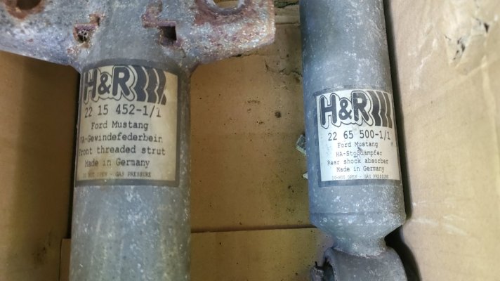

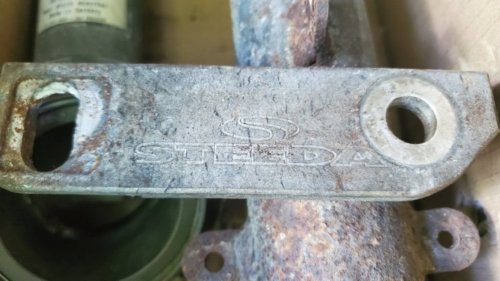

Another update. I no longer need the lowering kit that was on my 2005 Mustang gt. So, if anyone in the Ithaca NY area wants it and pick it up then it is yours for FREE. Pictures attached.
BTW, I am looking for the insulation piece attached under the front hood and the front splash gard under the radiator if anyone in the area has them, but I guess I could find them in a junk yard. 20240609_124020.jpg20240609_124031.jpg20240609_124043.jpg
