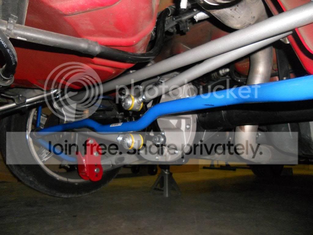

I looked at all the designs I could find out there and ended up going with the Whiteline version. No regrets and have been very pleased with the results.
The white line is an extremely similar design to Griggs. It's the superior design for a Watts link in my book. Minimum weight added, and almost nothing added to unsprung weight.

I installed a whiteline watts link last week and have been loving every minute I have driven my car. A little note though if you install whiteline piece. Don't pay attention to the torque settings in the instructions. Some of them are too high for the bolts. A little forum research will yield the proper values.
You do realize that diff mounted Watts linkages are almost all unsprung weight right? The WL watts weighs 29lbs, so does the Fays2, there is no way you can tell me that the WL is less unsprung weight.
I am getting ready to start my build with complete Whiteline suspension. Can you post up the numbers you used or where you found them?
