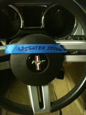

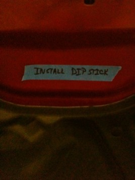

Yeah I have a little case of CRS so i do stuff like this.....
A roll of blue painters tape and a sharpie are great tools!!!! LOL!!!

Even my mechanic will had me blue tape all connections and odds n ends during my install, saves a ton of time. Oh and frustration when you go to start it and you forgot that one connection deep down I side somewhere that leads to 4 hours of work haha. Good luck on the new tune.
