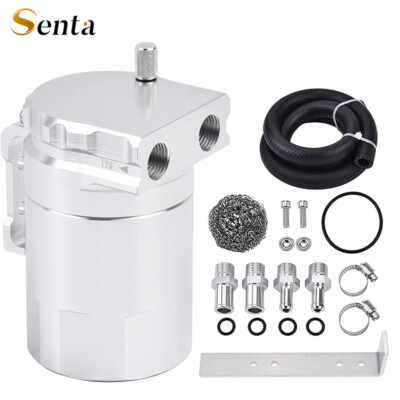

After I installed oil catch cans some five years ago, I noticed the engine oil stays cleaner for longer. Therefore I'd highly recommend a driver's side catch can at any mileage (a passenger side catch can is overkill but it's a bit more underhood bling.
Thanks DINO your always bring the good advice. I've been contemplating getting a catch can. You got any recommendations on which one to get as I value your opinions. I've been using the Mobil One 5w20 full Syn changed every 5000 miles.
Mine is almost identical to this and it works very nicely.:
There's absolutely no need to go for a $100+ unit.

Please explain WHY the catch can should be on the Drivers Side ? Why should it be on the divers ide as opposed to the passenger side where there is so much more room to install ? Thanks Brandi
The driver's side is where the intake manifold vacuum (naturally-aspirated engine) draws oil vapors from the crankcase via the PCV hose. On the passenger side, the vacuum under the valve cover (again in a naturally aspirated engine) pulls in fresh air from the intake tube in front of the throttle body. That should be oil free unless you have piston ring/bore blow by. Therefore a passenger side oil catch can is overkill though there's no harm in putting one there anyway.
Keep in mind that you need 5/8" rubber hose plus catch can fittings on the driver's side, and 3/8" rubber hose plus catch can fittings on the passenger side.
Nailed it. catch can goes on the driver's side. With ford semi synthetic 5W-20 oil used, my catch can would be almost full to the top, and look like a chocolate milkshake. It's a mixture of oil + moisture + gasoline.
With 100% synthetic 5W-20 / 5W-30 / 0w-30 oil, made by anybody, I get barely anything in the catch can...and it looks like new eng oil too.
Without the catch can, all that choc milkshake crap ends up on the blower elbow, all over the rotors in the M-90 blower, and all over the intercooler, and also all over the aluminum roush intake manifold....pooling up in the 4 x corners. It will also lower the octane of the gasoline used. It's one helluva mess without the catch can.
And that Ford semi synthetic crap is only 3% synthetic and 97% dino oil.
