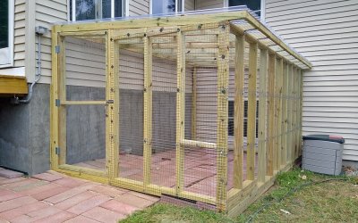

Yesterday, finished the outside of the new catio.
I still need to build fun things inside and a bunch of steps/shelves, places for them to sit on and enjoy the day, but it's done.
The plan is to install a screen pet door in the window screen, so they can go in and out through that basement window.
I built a little platform on the other side for them to get up to the window and get down, since it's about a 5 foot drop from that window to the basement floor

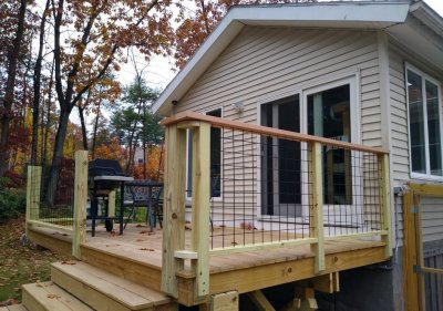

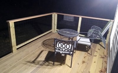

To add to things actually done to the house, I recently completed the deck railing. Went with a black Wild Hog railing setup, 4" squares, about 42" tall overall. The Wild Hog panels are 36" tall, plus about 4" below and the wood thicknesses below/above. The top pieces are 2x6 cedar. I used my table saw to cut grooves into the pieces of wood for the railing panels to sit into, then the toppers have their own grooves on the bottom for the top of the panels to sit into. Love the final look. Still have to do the railing for the stairs.

Looks great
