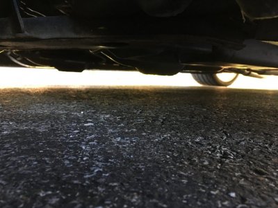

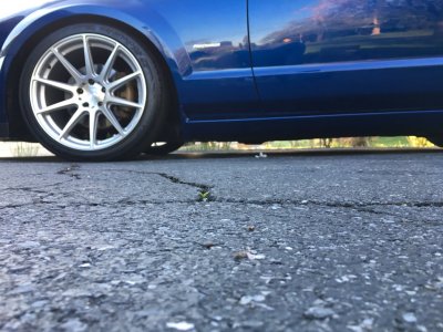

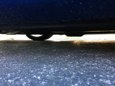

06JET
Mar 16, 2016
482
87
West Bend WI
Here are some pic's I took this morning. My car is pretty low but I have the option of raising it on the fly with the Airlift. A little dark, It was early.
You can see the Kook's High Flow Cats where the white rocks are on the driveway.
Yes, I have scraped them.
