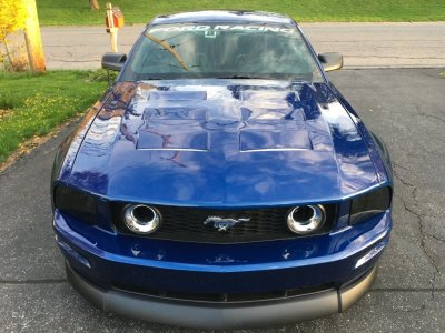

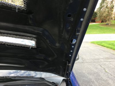

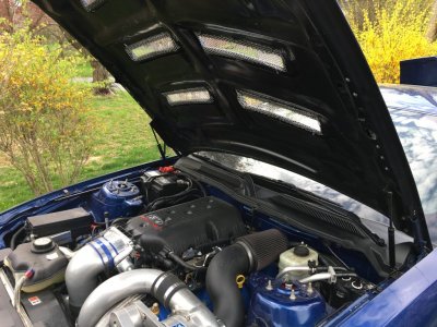

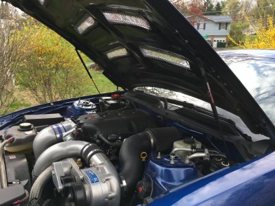

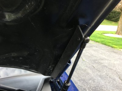

Today I replaced me hood struts with the Redline hood struts. The Redline are a much better choice for my carbon fiber hood. I love the look of my hood but I hate how flimsy it is. You can see the damage caused by the old hood struts and I only use them to hold the hood up after I open it. I had to put them on and take them off every time I opened the hood. The damage is just from the wind and the weight. I was worried so I put 3/4" wide metal strips inside the hood before I installed the ball connectors for the strut. I will get some black fingernail polish and touch up the rivets later. Overall this has been a long time coming. I love that I don't have to mess with the struts anymore when opening and closing the hood. Without the metal backing strips I installed I am sure the hood couldn't have taken the force the struts place on it. All is well for the 06Jet today.
Damage from old struts.
Metal backing strip.
Both sides done and ready for struts.
Complete. Doesn't open up as high as the other struts but I followed the directions on location and there is plenty of room/access.
Just need some black fingernail polish. I was even able to use a black plug to cover up the access hole.

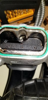

Did part of the blade break off or am I missing something?
No broken blade, that's just what they look like in the closed position. The delete plates claim a small horsepower increase, but i installed mine after reading about failures of the butterflies on forced induction motors. More of a safety precaution for me.
