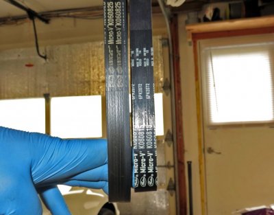

Replaced the Whipple's belt with a 1"-shorter Gates K060815 belt.
A somewhat tight fit, but the tensioner still has a little room to move, and this will hopefully eradicate my belt-slip and wonky-boost-levels issues.
About 3/8" shorter when pulling on both belts side-by-side:
(old belt almost 3 years old)

What tensioner are you running?

Gabe, glad the shorter 1" Gates belt fixed you're belt-slip and boost level issues :waytogo:

Thanks Rocky. Not sure yet that the new belt fixed my boost issues, I haven't had the chance to drive the car enough yet to figure it out.
Plus, it's hard to keep an eye on the boost gauge when the gas pedal is matted, lol

Seems to make sense that a 1" smaller belt should fix the belt slipping issues IMO, Gabe. I think once you have the chance to drive the car enough, it should also take care of your boost issues as well. I also know what you mean about keeping an eye on the boost gauge when the accelerator pedal is matted lol.
