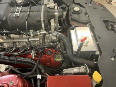

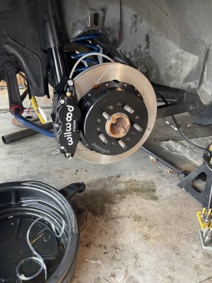

D705B1F2-2411-40C8-AFD5-F6A899FD71A8.jpeg Been a busy couple of days. First, I did my yearly serpentine belt replacement. With the E-force SC a roadside replacement would be impossible if it ever broke, so I proactively replace the belt every year. Then I replaced a leaking crankshaft position sensor. Finally, after a six week wait, the rear Wilwood brakes were delivered. Had to pull rear axles for the install, so I replaced bearings and seals.
It took a bit of adjustment to get the calipers in just right. I have an early 05 model and it seems there are a little discrepancies compared with most units as I had a unique fitment problem when I did the fronts. Kit requires new parking brake cables. I had to replace the drivers side cable anyway since it was broken. It also appears that the drivers side caliper was not working and was rusted up. No wonder the car didn’t want to stop at the track! Ran out of energy for today, it sucks getting old. Tomorrow I have to adjust parking brake and I’ll do the relearn procedure for the sensor and bed in the brakes. If it’s not raining.

View attachment 77297 Been a busy couple of days. First, I did my yearly serpentine belt replacement. With the E-force SC a roadside replacement would be impossible if it ever broke, so I proactively replace the belt every year. Then I replaced a leaking crankshaft position sensor. Finally, after a six week wait, the rear Wilwood brakes were delivered. Had to pull rear axles for the install, so I replaced bearings and seals.
I hear you bro. When I did the wilwood install on the Shelby I was using a lift, and it still took two and a half days. They actually sent me the wrong brake cables. I think they were for 2011. I had to do some cutting and grinding on various parts. Well worth it.

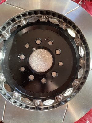

. The parking brake cables were easy. It’s the safety wire that sucks. This photo is actually my front rotor. The rear ones had a raised lip on the inside, so the bolts were recessed by 3/4”. 3.5 hours to do two rotors and my hands were starting to cramp up.
Safety wire sucks!!!

I passed on the safety wire. I figured clean threads, red loctite, oughta hold. I know wiring them is absolutely the best way to go, but I just couldn't do it.

You’re probably right about the Loctite Red and proper prep. I know some other brands of floating rotors don’t use the wire and reply just on the thread locker.
Mark the head of the bolt(s) with a paint pencil. Then you can tell if it’s moved over time with out putting a wrench on it.
