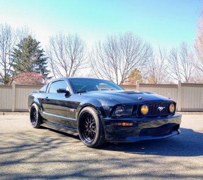

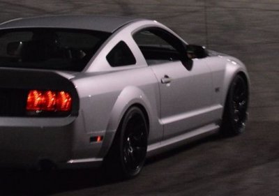

Curious to see your new set-up. I'm running square 275/35's on rarer all black finish Shelby CS40's. Good call on the black rivets, I'm actually changing my chrome finish to black to blend with the black CS40's, chrome rivets seem so '90's, lol. (and yet were so "cool" not that long ago...)
I was a little nervous about the +30 offset, especially after reading forum articles about wheels being +40 - +55 offset in the back and some gross ass weird offsets in the front making the wheels looking almost completely flat lol.
I haven't heard a tire rub all day!

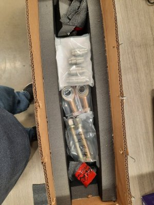

Messing around in preparation to replace the front seats in the GT. Going to Braum Racing high back seats, I will loose the airbags in the seats and I want the dash bags to remain operational. I unplugged the airbag connector under the drivers seat and plugged a 1/2 watt 2 Ohm resister into the chassis harness. When I start the car, everything is clear and it appears the system is operational. I will do the passenger side next.

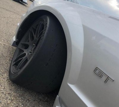

As long as u like the way it looks. To me I’d never drive a car with a set up like that ^^^

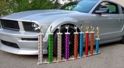

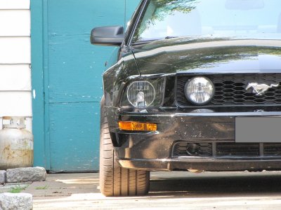

A little 'poke' can't be avoided when you're running 11" wide wheels up front for the corners. The picture below is running at an effective offset somewhere around +35 (there's a thin spacer involved). I'd probably have to go to +30 if I went from 285s up to 305s.
On the matter of appearance, it looks just as 'right' to another track day regular as big M&Hs out back with skinnies up front look to a drag racer.
Thats not true at all. I'm running 315s on 11s up front and 335s on 12s in the back and they fit inside the fenders.
I'm not a fan of stretched tires with the wheels sticking out but thats a style thing. I'm a fan of performance.

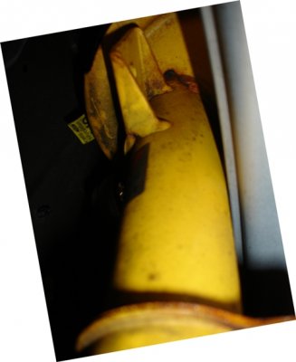

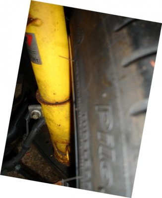

That suggests to me Cortex's struts or similar with slightly greater strut body to knuckle offset. Cortex was unknown to me at the time I was shopping for better dampers than OE.
In the picture I posted of my RF corner, there was at most 1.5mm clearance between either the wheel or the tire to the standard Koni yellow strut body. And on that RF corner I had to make up a shim-thickness spacer out of 0.025" aluminum sheet to even get that much.
It doesn't rub, but there's no way the front wheels could be brought any further under the fenders. The 'stretch comes from MPSS not being available wider than 285/35 in 18". Supposedly there's a 295/35-18 now, which would require more spacer thickness.

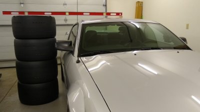

Just one more pic that I don't think I've posted here before and its keeps up with the Vorshlag tradition of posting tire stacks. My tire stack is taller than the car. Thats a piece of 2x4 on the roof to make it level. Plus the car is on my street tires which are bigger diameter (= higher roof) than the Hoosiers.
Follow up on using resisters to turn off the airbag light when unhooking the front seat airbags on a 2010 GT. The 1/2 watt 2 Ohm resister works on the passenger side as well. :)

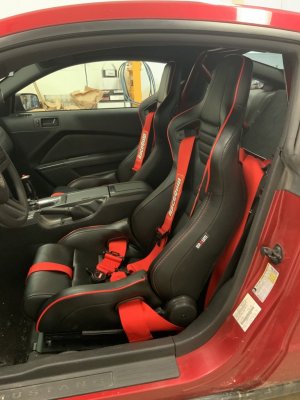

Just finished the install of Braum Racing Elite R seats. No seat airbags and the resisters I added make the system think everything is normal. I did use the proximity sensor under the drivers seat and the factory seatbelts are fully functional. Also removed the bladder from the stock passenger seat and slipped it into the new seat. What a bitch getting the bladder out of the original seat. 5 point harnesses are mounted but not yet trimmed.

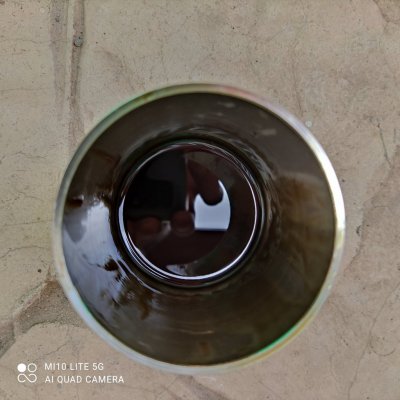

Decided to check my driver's side catch can since I installed it some 4000km ago. There was about 40cc of oil in it or roughly 10cc per 1000km. Proof that my $25 Chinese eBay catch can with Scotch Brite scouring pad as a filter medium really does work (no need to spend over $100 to buy one). Much better than having 40cc of oil coating the inside of the intake manifold and the back of the intake valves that's for sure! The CMCVs would have been coated too if I hadn't already deleted them seven years ago.
My engine has 94k miles and the dipstick oil level hardly moves over a 5000 mile oil change interval (full synthetic).
