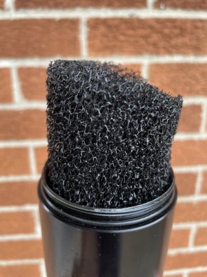

Decided to check my driver's side catch can since I installed it some 4000km ago. There was about 40cc of oil in it or roughly 10cc per 1000km. Proof that my $25 Chinese eBay catch can with Scotch Brite scouring pad as a filter medium really does work (no need to spend over $100 to buy one). Much better than having 40cc of oil coating the inside of the intake manifold and the back of the intake valves that's for sure! The CMCVs would have been coated too if I hadn't already deleted them seven years ago.
My engine has 94k miles and the dipstick oil level hardly moves over a 5000 mile oil change interval (full synthetic).
I did something similar. I used a prefilter material from my aquarium inside the catch can. Works great.
I pulled the ADD W-1 catch can off my car & replaced it w\ another similar type catch can but it uses SS mesh filtering (looks like a Brillo pad) contained inside of a removeable threaded double baffle design on the inlet side of the can to improve oil vapor collection\removal thru the double baffle chamber w\ the dipstick protruding thru the outlet port into the can. I like this setup as now since the dipstick is located in the outlet port, if any oil vapor is getting thru the SS meshed double baffle it can be seen collecting on the upper part of the dipstick along w\ any collected liquid oil level on the lower end. The ADD W-1 catch can I was using prior was using baffling only, which while it did show to be working it also showed that it wasn't perfect & due to the baffling design in it wasn't conducive to adding enough SS mesh to my liking to help improve it so I replaced it.
Been in service now for 2 weeks....so far the dipstick shaft is bone dry thus the intake manifold.
