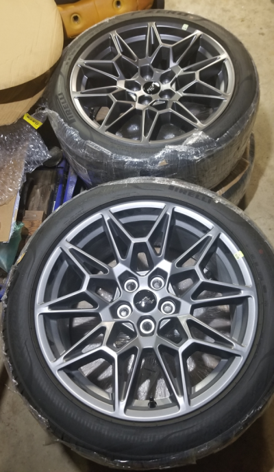

Got some new shoes!

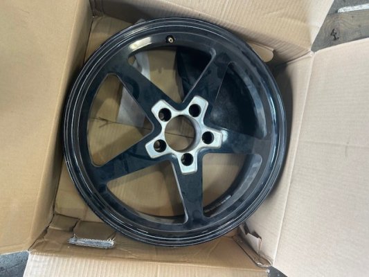

So, as many of you know from my sig I bought new takeoff 2018 GT wheels in 2018. I needed tires anyway and decided it was time for a change.
Found out Shelby is selling new takeoff '24/25 Performance Pack wheels on ebay and scored this set for $1200 shipped. I wanted performance pack wheels from the get-go but didn't like the black ones they ran on the S550- these ones are sweet! Will be putting these on in the spring.

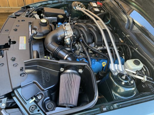

If you have a conical air filter, stretch a L'eggs knee high over it. They're really cheap, and they'll keep out grass, leaves, pine needles, maple seeds, etc. I have noticed 0 change in mileage and performance.
They also make a great lint filter for your washing machine.

They look great. What sizes are the tires?
I have a 2024 with that wheel and tire set up:
245 x 40 x 19 front
275 x 40 x 19 rear
I think he mistyped, they are 255/40R19 fronts (19x9 wheel) and 275/40R19 rear (19x9.5 wheel)
I've been running 255/40R19's all around on my 2018 wheels so this will give me a little (very little) more width in the rear.
JimC
May 5, 2007
2,339
720
Correct, hit the wrong number - 255 on the front.

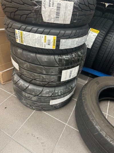

Making some progress at my buddies shop. INstalling Scott Rod Underhood panels and paint matching to car. Temp fit along with home made catch can/puke tank. Also new wheels and Mickey Thompson tires front and rear. All kinds of goodies I will be posting pics of soon. Sold all thew 03-04 Cobra Brakes with the 93 Cobra Booster and Master. Installing all new TBM Street Brakes front and rear with master cylnder

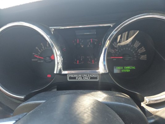

I was yesterday's age, when I discovered that a 2008 Mustang GT, with a tuned/CAI but otherwise stock 4.6 3V and TR3650 could run approx. 25 minutes on 10.8 volts of battery-only power. First, I got this in a parking lot 12 miles from home:

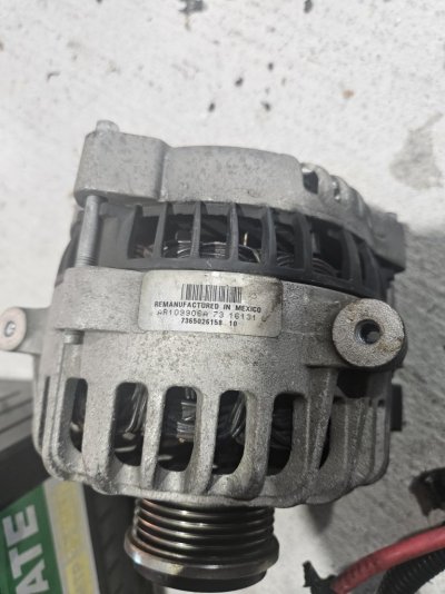

I have a lighter-plug phone holder/charger, that happens to have a digital voltmeter, in the dash...so could monitor the debacle, in real time. I also had documentation that the previous owner had the alternator replaced in 2017 (at 77K) and the real-world experience from members of this forum that the reman alternators were crap, which proved to be true with me, as well:

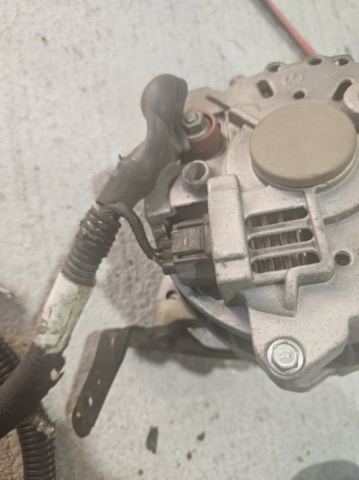

Removing and replacing both was very straightforward and the only detail not covered by the multitude of YouTube videos was the separation of the 3-pin harness from the factory positive cable and reusing it with the upgraded one, pictured below:
All in all it only took about 90 minutes, from start to finish, including cleaning the battery terminals and zip-tying everything to tidy up the (now separated) cables. 14.2V at the battery when running (had been mid-13s, previously) and the added energy seems to be noticeable in the SOTP dyno, as an added bonus...
