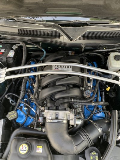

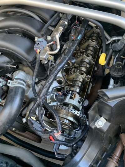

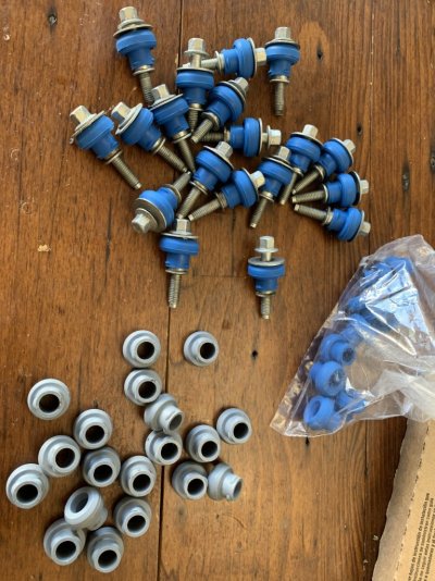

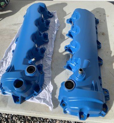

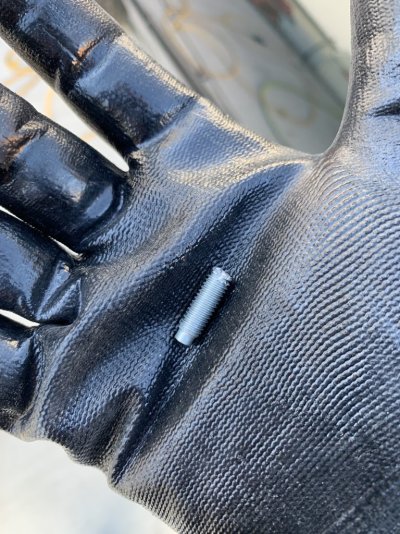

I took off the valve covers to see what's inside. now I know, there are .....stuff.

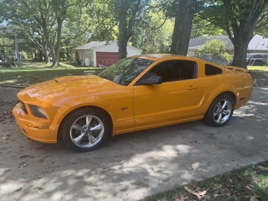

Did quite a few things this past week.
New O2 sensors
New spark plugs (NGK 6510s) and regapped
New splash shield
Bled my brakes
Changed the oil
Flushed the water out and added antifreeze.
Replaced some of the worm clamps with tbolt clamps on my charge pipes
Cleaned the car
Looks and drives amazing now.

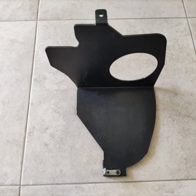

Made some improvements to the heat shield of my JLT 3 CAI to ensure it's properly sealed from the hot engine compartment.
Before:
After:
Trimmed some excess material from the bottom, added some extra material at the bottom of the back wall, and created a new floor.

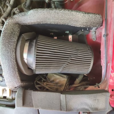

As installed:
I added thicker foam trim along the top so that it seals properly against the hood (the original rubber weatherstrip was inadequate and left a 1" gap in places). I also sealed the gap between the pipe and heat shield.
Now it performs like a proper cold air intake! :D

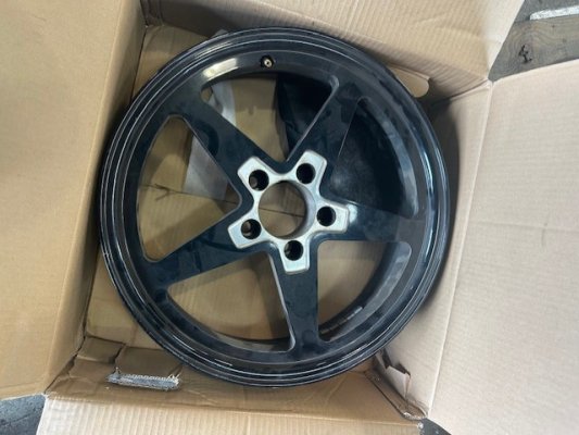

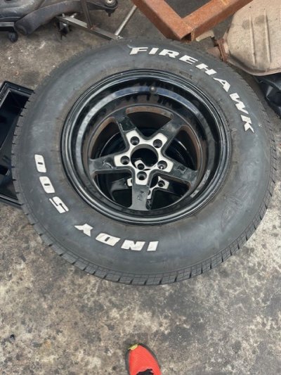

Ok I could see the tire decal that the front skinny’s were 17” but could not see the rear.
Beautiful rims and those fat meats will look and hook great on the fox!
