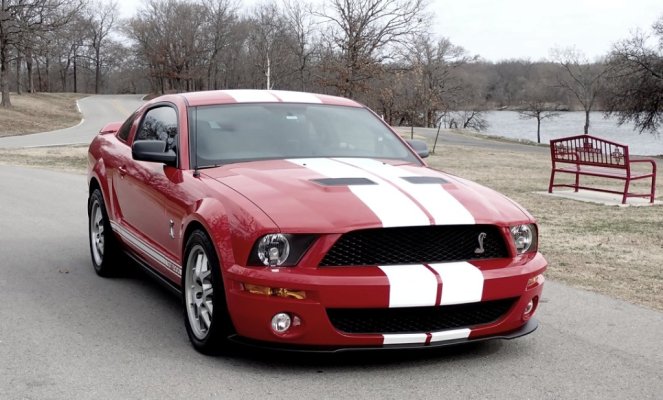

Wife is thinking it's time to sell her Shelby ... Last few years she's driven it like 2-3 times a year, I drive it more than her but even then we're always under 1k miles per year ...

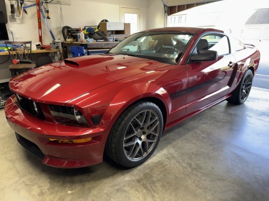

I’ve been busy trying to wrap up loose ends with the coyote swap. I took it in and had the exhaust done so that’s finally taken care of. I got it aligned this week as well since I did the EPAS rack with the swap. My father in law and I hard wired a relay in for my reverse lights since they weren’t working after the swap. Lastly, I got it inspected for the year so now I can enjoy it.
I took some time today to polish the car after a long winter of being torn apart. Still have to do tires, trim, and glass. Currently I am waiting on a coolant reservoir so I can ditch the JLT and put the PMAS cobra jet intake on it. I’m hoping to do that sometime this week.

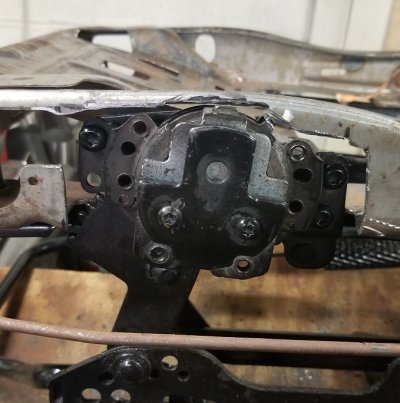

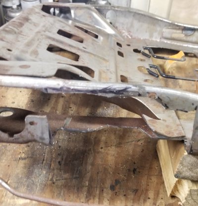

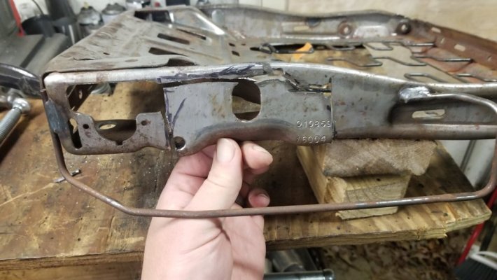

Ok after a couple hours of trimming and test fitting I got it done tonight.
So this is the piece you have to cut out, and you have to bend up the piece inside a bit to clear the back of the ratcheting mechanism.
After a little more grinding and clearancing, the finished product. This was actually easier to do than I originally thought it was going to be. I actually cleaned it up a bit more after I took this picture. Tough area to work in due to the little steel bar that the side trim attaches to.
I found out after putting the seat foam back on, you also have to trim the seat foam to clear the ratcheting mechanism. Not a direct drop in but otherwise pretty easy! Of course you also have to get the correct side trim piece (I happened to find one on ebay last week) and handle for the mechanism.

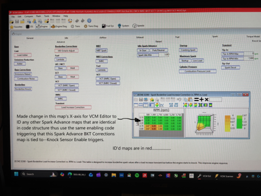

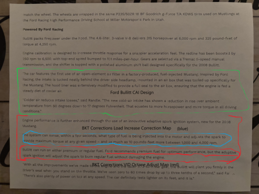

Provided below is a snippet of an article that a Ford Racing SVT lead engineer named Paul Randle gave info during article interview on these 08-09 Bullitt components\features\calibration tuning that set a 08-09 Ford Bullitt 4.6L apart from a 08-09 Ford GT 4.6L engine-wise...........even though the engines themselves are totally identical in every aspect of design...........so far, I have the CAI & 1 of the 2 calibration features mentioned (BKT Load Increase Corrections) fully set up & operational in my current 09 GT strategy...........work in progress on the 2nd one, believe I've figured out how Ford coded the BKT VID Octane Adjust function to work--triggered off same KS Retard Control that triggers the Load Increase Correction function, just in reverse (Load Increase Correction function is applied in addition to base BKT spark advance timing when the KS Retard Control applies max KS spark advance timing set in Max Advance mapping according to load% & RPM to base BKT spark advance timing due to no cyl knock detected\reported during initial TPS advance sweep thus transient throttle application--improves low RPM acceleration response between 1,000-4,000 RPM range--emulates distributor mechanical spark advance--vs VID Octane Adjust function is applied when the same KS Retard Control retards spark timing from detected cyl knock activity that goes BELOW the base BKT spark timing map settings regardless of transient throttle or steady state throttle.....AND the BKT\BKT Corrections\IAT & ECT Spark Corrections are within their perspective deadbands--the 0* spark timing sections which signifies to ECU that the knock is "octane related" & not IAT or ECT hi-temp related or excessively advanced IAT or ECT spark timing from cooler denser IAT or cooler ECT due to environmental changes......thus will pull the VID Octane Adjust map's set amount of spark timing according to engine load% & RPM the cyl knock was detected at from the base BKT Spark Advance timing map due to "lowered fuel octane" to stop the knock, set this in KAM & will hold this setting until the ECU detects that the knock has stopped & the KS Retard Control has recovered all of the retarded spark advance timing back to the max KS spark advance timing map settings, then ECU will remove the KAM set base BKT retarded spark advance timing & allow the normal base BKT spark advance map timing to resume being used along w\ all BKT Corrections......this is why I believe the fuel octane AKI level needs to be set higher than 87 oct in GT calibrations for this function to work properly.........as is done in the Bullitt calibrations & Ford alludes to in the FWM.
The following maps under Spark Advance that pertain to the functions posted above are linked (they use the exact same map X-Y scaling & if any 1 scaling setting is changed in 1 of these maps, the same changed setting is also made automatically in the other scaling maps under VCM Editor software........thus 1 can find out which maps are linked together in calibration thus NEED to be scaled IDENTICALLY to prevent potential code threshold violations.....or leave the stock map scaling\settings as set by Ford to prevent underlying code contention violations............) as found in picture below (linked maps are in red)..........
These shown aren't the only ones linked under this section either, FYI..............
Posted for informational purposes...............

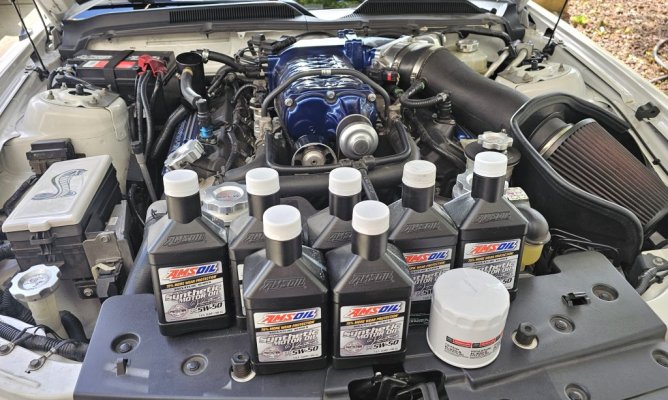

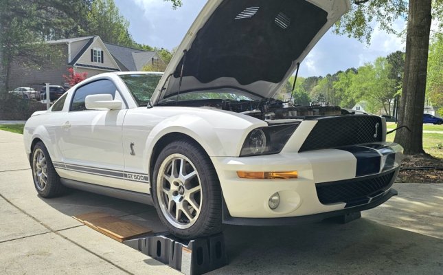

Wife's Shelby. Did an oil change, emptied the catch can, and cleaned it up a bit.
Waiting on new pinion seal parts to have that done before we start driving it this season.

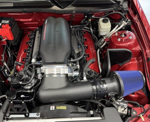

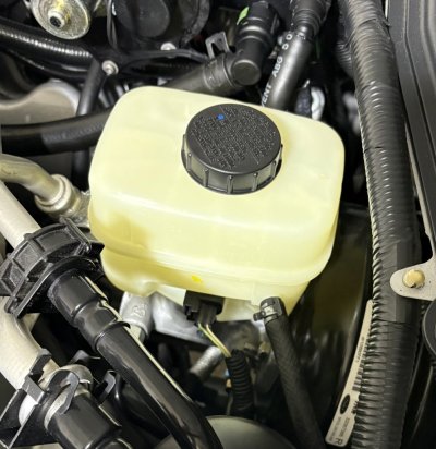

I recently watched a YouTube video on a 500+ whp Boss302 that was running the PMAS intake and used another coolant tank to make room. I reached out to him and he provided me details on the tank so I bought one. PMAS was my original intake choice but when I couldn’t make it fit I ended up with JLT.
Anyways, the coolant tank arrived and I installed it. Everything fits well, unfortunately the tank has a bad weld on it. I’ve reached out to the company and I am waiting to hear back. The car idles smoother with the PMAS, but due to the leaking coolant tank, I can’t drive it to see if the drivability has improved.

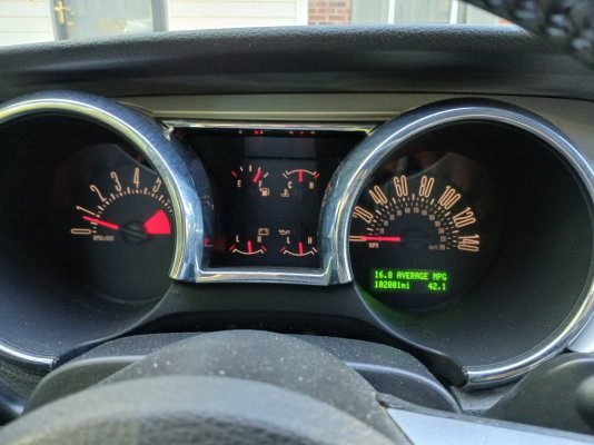

2005 Mustang GT, 4.6L
Vortech V2 SC
5-Speed Automatic
Tires aired to 36 psi
Complete first evaluation of manually checking number of gallons used -vs- instrument monitor, and mpg, manual -vs- digital monitor.
Manually checked: 10.9 gals.
Digital monitor: 11.0 gals.
Manually checked mpg: 16.8
Digital monitor: 16.8
Instrument monitor: 27 mph.
I plan on repeating this test.
I used 93 octane in the 2005 GT 4.6L.
Driving was in town, various conditions.
