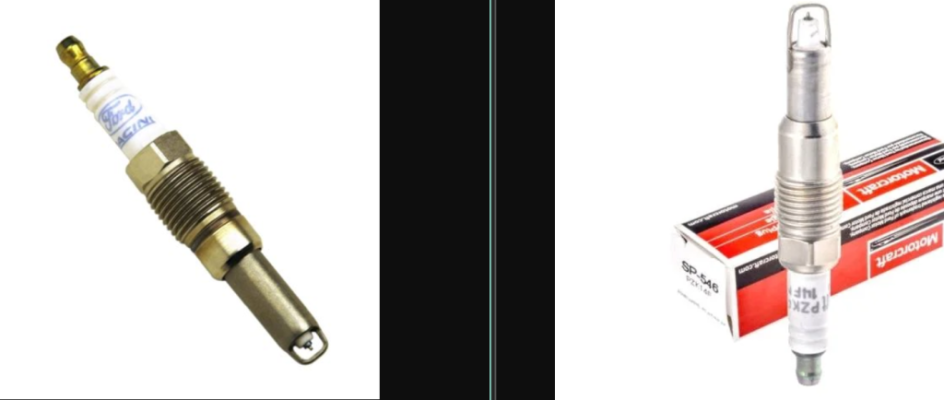

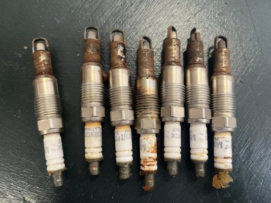

Here's my OEM plugs, the insulator is definitely a lot shorter
Interesting for sure. I’ll grab a measurement from the old plugs tomorrow just for science.

To keep the plugs ftom seizing in the cyl. head, would it be worth it to R&R the plugs every 20k miles or so? (clean the plugs and put a small amount of anti-seze on the threads)
Definitely, a bit of anti seize at the metal tip where the carbon gets stuck. The threads should be not an issue. Or maybe once a year just take them out and clean. That's what I do now (after I left them more than 10 years in and needed 2 days to get them out).
cavero
Jun 30, 2012
912
281
NoVA
Yeah definitely some nickel anti seize on the sleeve, probably not the threads or you can risk over-torqing them.
I've gone as long as 40k before changing mine, but you definitely won't hurt anything by doing it sooner--other than your wallet, that is.
I've also put in E3 spark plugs because they're one piece, not because of any claimed gains (there weren't any, the car ran fine though)

Sorry just realizing I missed typed yesterday. I put in the SP547X. Not the SP546X. I do agree though. Definitely a shorter sleeve on the ones I pulled out. They seemed to run just fine though.
When you look at the porcelain color, yours are white and the other used one are brown. I would change them to the desired type. But, also don't know how critical that is. I'm not a spark plug augur ;)
