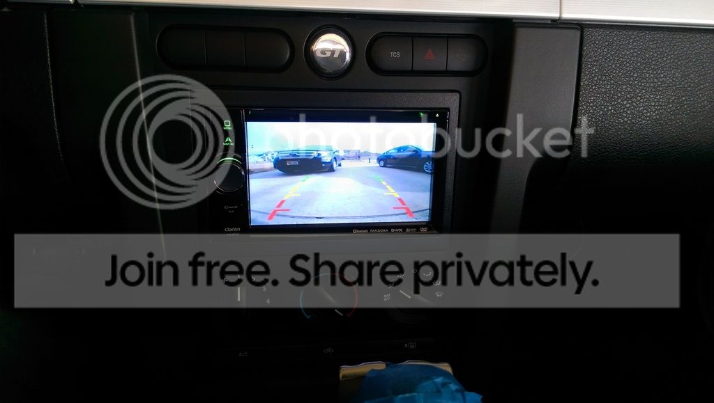

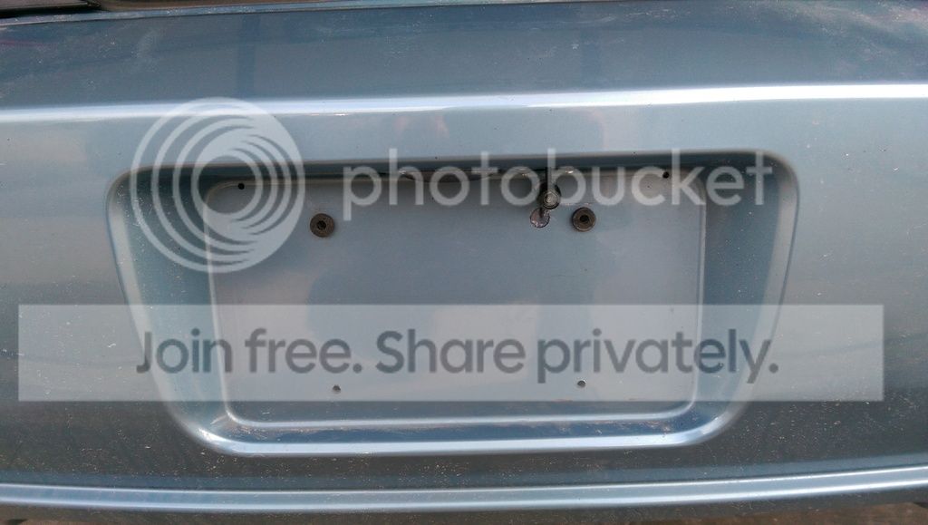

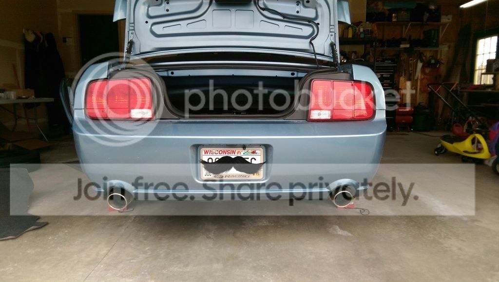

The camera was pretty easy. I had an extra open power source from the painless block I had installed during my supercharger installation. So I ran a power wire back to the camera from that, I also tapped into the reverse light wire for a signal source. So with the NX404 it will automatically turn to backup camera when I go into reverse plus I have the option to turn on the backup camera anytime manually. I drilled a 1/2" hole behind the license plate and then a hole through a rubber stopper that was already in the spare tire well to run the wires. Then I filled the holes with some silicon caulk I had leftover.

I have the camera on the same location and I think it sucks. Doesn't give you a good perception where things are.
I use to have it by the trunk keyhole area when I had the Saleen Kit and was perfect.
I could see the edge of my bumper and etc/

The camera does have markers and for me the yellow hash is about 20 inches from the bumper. But I agree if you had a small view of your bumper in the field of view of the camera that would give you a better perspective.
I didn't buy the head unit to get a backup camera but since it had the capability and the camera was only $20 I figured why not hook it up. If you need a camera you might find other mounting options give you a better perspective.
