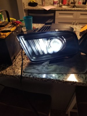

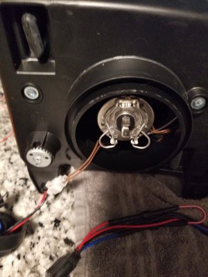

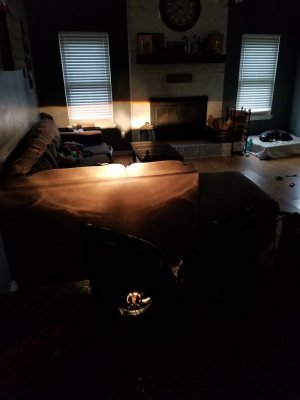

Bought the headlights and led stuff over a year or so ago. I havent installed them yet, been slacking lol. Stuck at home today because of the storm so hooked up power to test it all out. Here is halogen first

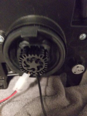

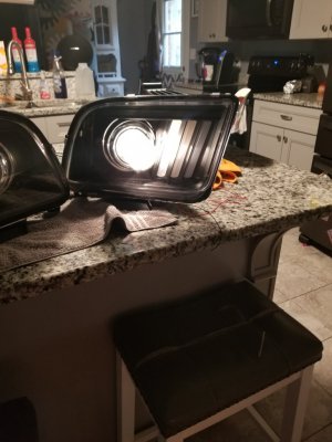

And here us the aux beam led. Its a h7 2 beam that clocked right in the correct orientation and locked no problem.

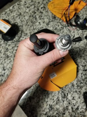

Needless to say led lit up the room better and is a more white vice yellow light so def wont be using the halogens. Here are some bulb pics side by side. All I had to do was modify the boot so the heat sink and cooling fan on the led bulb can stick through.
