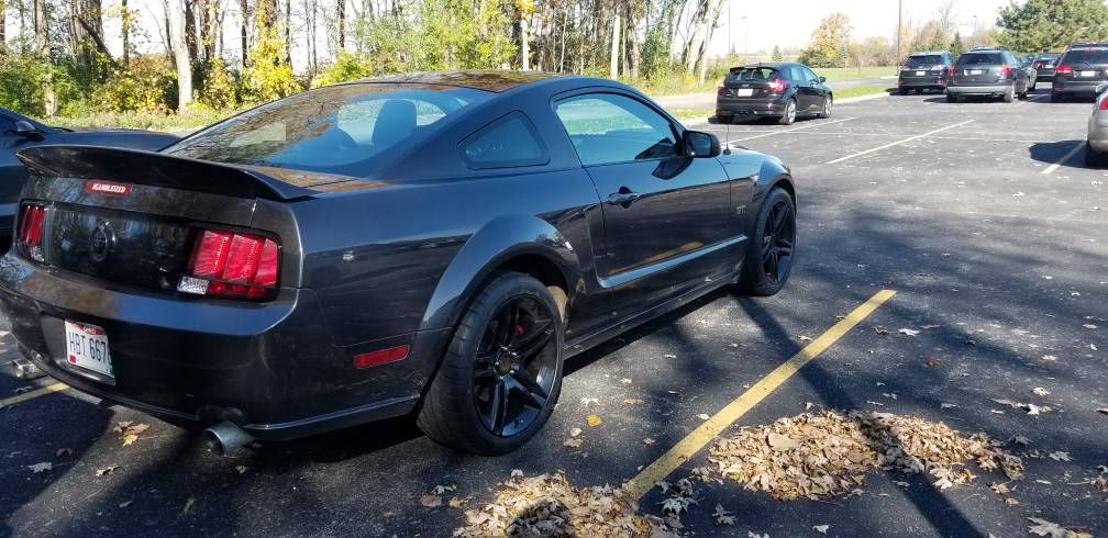

Well here she is. I didn't fall through.
