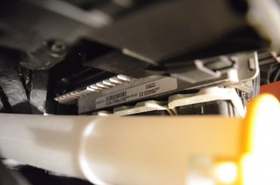

The part number on the ECU. I will post a picture. Then you can look it up yourself. It's listed in the Hollander Index for use with 2013 and 2014 Boss Engines.

ECU Picture 2014 Mustang GT made Aug 2013. I hope it clear enough. ACC ACD and ACE can be used in any Boss or Standard 2013/2014 Mustang GT.

Pcm code is KWC3. This is for a GT coyote. I am running KWC4, which is an updated version, likely for 2014 MY.
The last 3 letters are revisions of a Ford part number. First 4 of the part number are year/vehicle, the middle numbers are the "part". So 12a650=pcm.

All may be true but the Hollander Index says any ACC ACD or ACE version will work in a Boss. Is this the dual path Track Key version for both 2013 and early 2014? Track Key was available to the 2014 early versions but was discontinued when it did not work for all 2014 Mustang GTs. It seems the KWC3 is for a 2013 Mustang GT Boss ACD. So all I am saying is this is a Dual Path ECU that will work on both Boss and Standard Coyotes by Hollander Index.

Correct, but what Hollander does not mention is the programming needed with IDS after replacement.
As for the track key option, that is stored in the instrument cluster along with the PATS stored keys. But you need the Boss software in the pcm to be able to use it.

What makes you think the Boss software is not already in it? So what would happen if they did use the leftover 2013 Boss long blocks sitting in the six trailers in back of the plant for some of the first builds of 2014. They would not have manifolds on them. Just the block and CNC machine heads with a slightly different cam. I may not know the exact numbers but I believe 2500 Boss Long Blocks were made and 1500 were used in the 2013 production run. Then the production manager gets a note that no more Boss production for 2014. What does he do with the rest of the engines? As far as Track Key, I have heard it's in the Cluster but I also heard it's in the ECU that will take two programs at once. I was thinking of a premium cluster using Ford Scan. No where in Ford Scan that it says there are two programs in the cluster. Then if you understand Track Key, they say it will work with the standard clusters. No matter how you look at it, there are about 1000 missing Boss Long Blocks.

Two things: KWC3 is not for a Boss.
You said the revs are limited to 6850. Boss software would let it rev higher. Boss intake and cams are also different, and that also has to be addressed in the tune.

I did not say it had boss software on it. People tell me what it isn't without telling me what it is. So the proper response is, KWC3 is not for Boss but RWD4 is. People can't even agree on how many Boss engines were made between 2012 to 2013. One guess is 4016 were made for 2012 and 4273 for 2013. Now the question is, how many were made for the 2014 canceled production run? So if you tell me what can't be true, you MUST also tell me what can. Then one record does say the exhaust cam is slightly different from Boss to Standard. Everyone knows a Gen 1 Truck Coyote with a different exhaust cam runs great with a gen 1 5.0 Mustang GT software. I would think it would be the same with a Gen 1 Boss and a Gen 1 standard engine. The only reason you can't use Gen 1 software on a Gen 2 is because Gen 2 is not a full VCT engine. You could never get it to Ghost Cam. Then we are only talking about long blocks. There was a group someplace that installed a standard manifold on a Boss and they felt it made much better power in the low end with not much fall off on the top.
