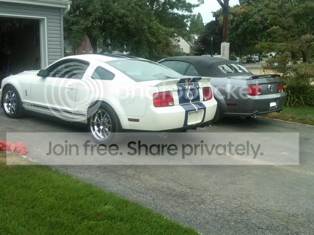

Cheap SR cast chrome wheels, held up fine for me for a few years.
