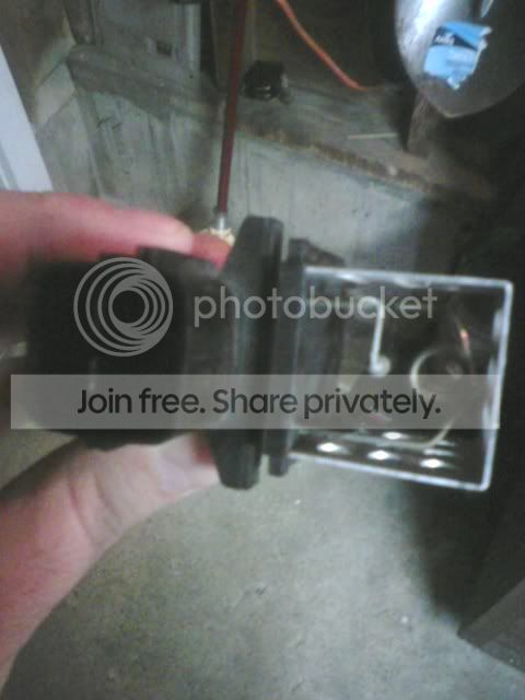

I know you said the fan was running, but was it running on low or high speed? It's possible that POS resistor on the back of the fan shroud has failed and even though the fan was running, it was only running at high speed when the coolant temps got high enough for the PCM to command the high speed fan come on.
That is a great question. I do not know if the low speed fan was running. It can be very possible it is not. If the low speed was shot, would i need a whole new fan? or can i just change the resistor?

Normaly its just the resistor that goes bad on the fan shroud.
This guy:
JeremyH
3V Fuel Guru
Jan 10, 2009
20,857
207
Virginia Beach
Yeah I think so. Mine went bad so I found a lightly used one here off the fourms for cheap.

hmmm. I dont see it on Rockauto or Tousley ford. Gonna have to call

if i pull mine out, is there an easy way to tell if its shot? will it be burned up or something?

Not always mine looked rather okay from the outside. But my high speed fan would not come on at all. I would first check the fan to ensure low and high speed come on. Just start the car and wait lol or you can set the fan settings really low with your tuner. Ive always been told to to keep the low speed fan close to or right above t-stat temp and then high speed set 10-12 degrees higher than that.
