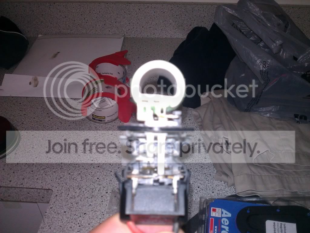

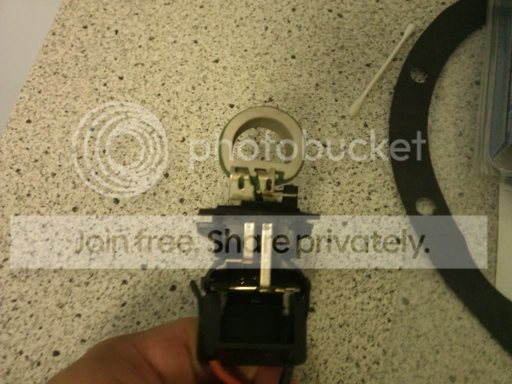

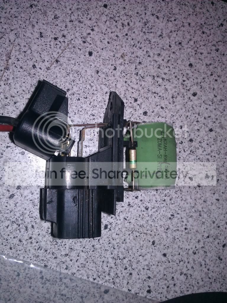

well I don't think my resistor was fried, but i replaced it anyway. I need to verify if the low speed fan works or not now.

well yesterday, it was 80 degrees outside, and sitting in traffic for over 15 minutes, temps never got above 184. I still want to test this on a 90+ day to make sure changing the resistor and editing the fan temps has solved the issue.
