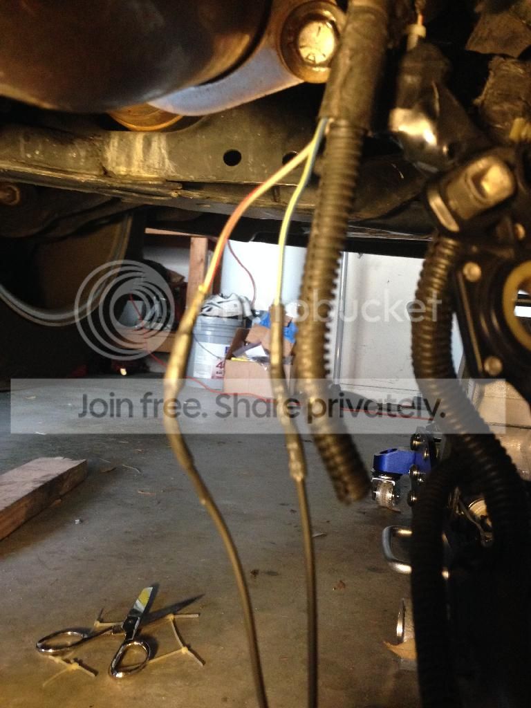

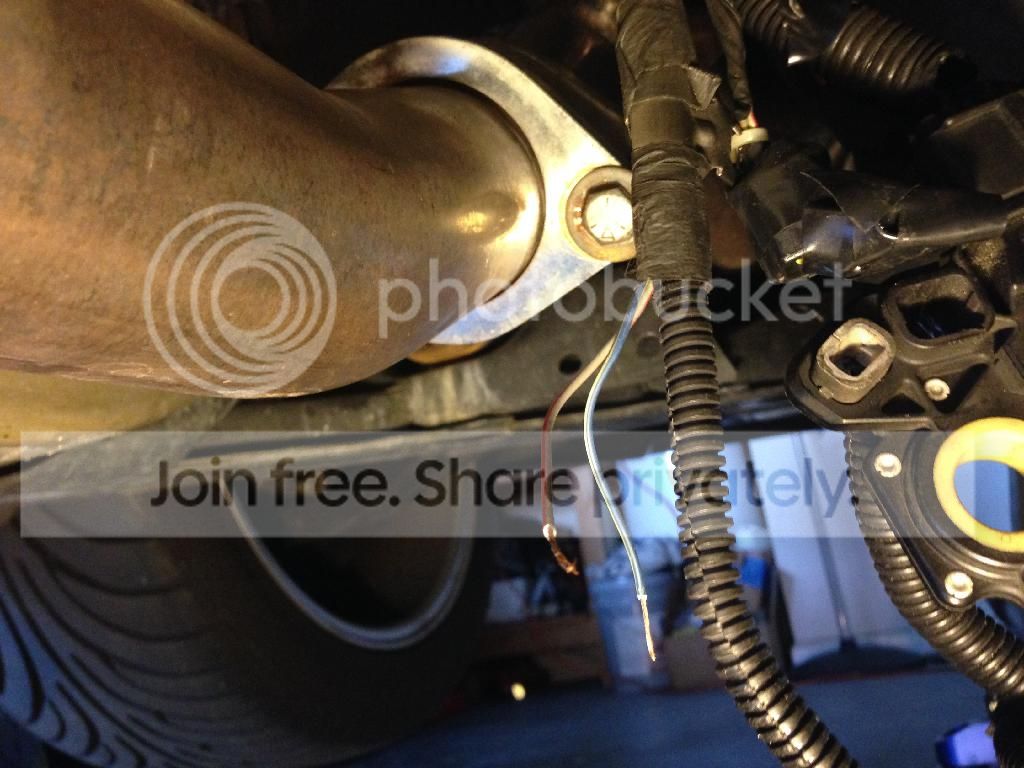

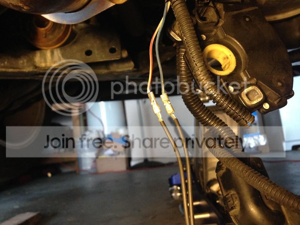

The positive is, I fixed my speedo today. I had the correct wiring but te crimp style method didn't work for me. I tore off the heat shrink and ended up soldering the wires together and it works!
This was what I originally used and it didn't work..
Also that big box(neutral safety for the auto is no longer there.. I cut both wires out of the 12pin plug to solder together which allows the car to start. These are older pix from last week.
