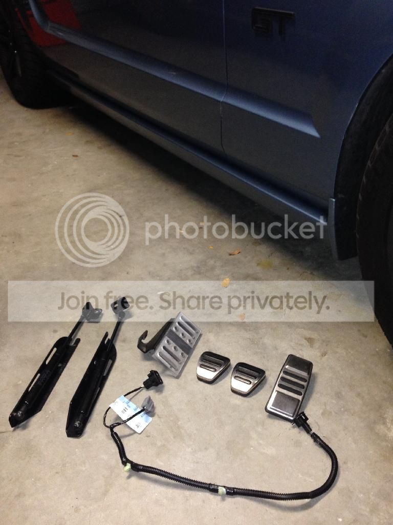

Got a few parts from Skwerl today, sad to see the bullitt look like that after a few months ago of seeing it in immaculate condition..

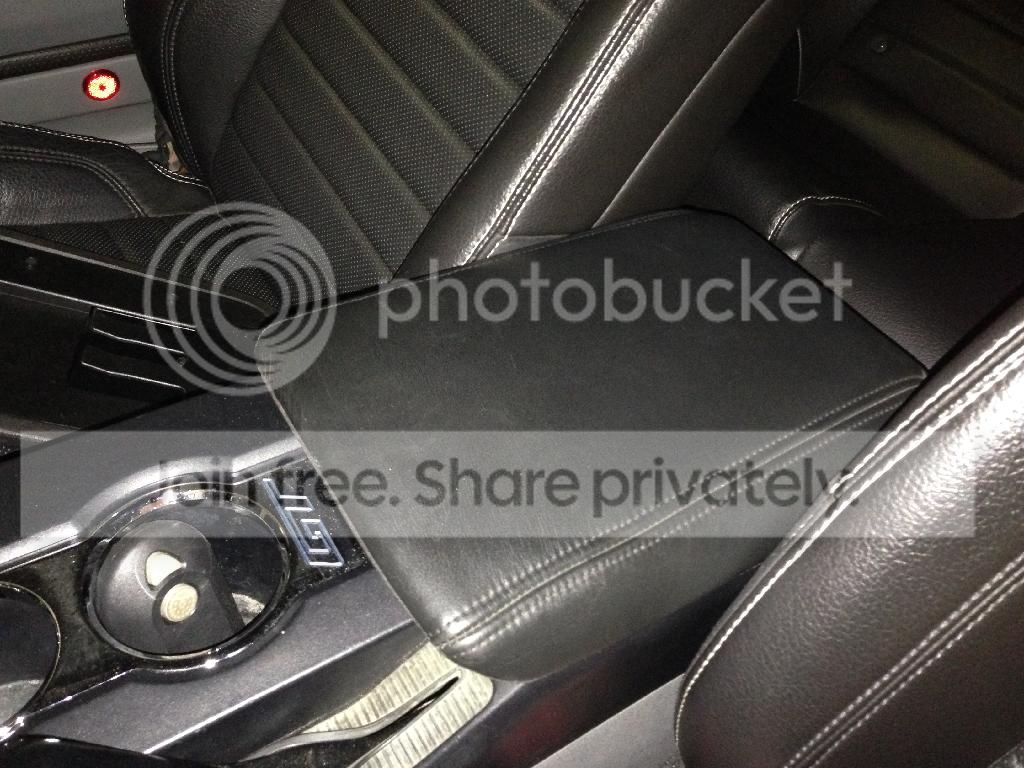

Got a new center arm rest with a leather wrap. Feels and looks so nice!
Haven't had time to install the hood struts, or the pedals from his bullitt but it is going to look great. Also got a harness from him to plug in my clutch/brake pedal switches. I will see if the cruise control works after I install it.

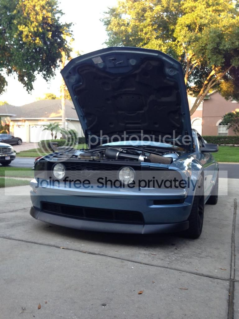

Got around to installing my hood struts today..

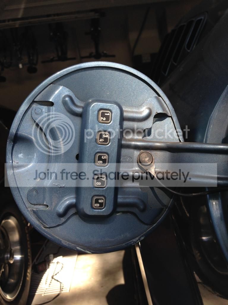

what is that on the gas cap door? Is that a remote for your doors?
A keyless entry, I type in a 5-6 digit code and it unlocks my door(s) and or trunk.
