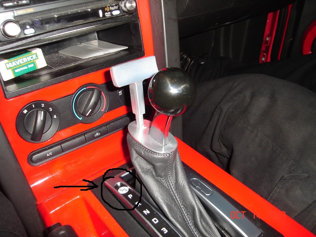

Hey, has anyone successfully removed the overdrive button from an 05 to 09 Mustang GT shifter without breaking it? Need to know how. Thanks.
Can I just ask why you want to remove the button from the handle? Curious.

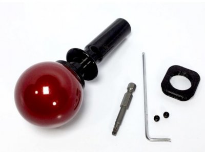

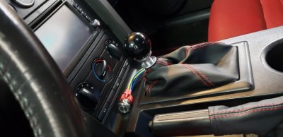

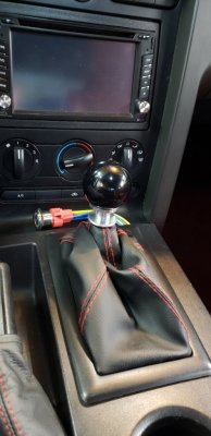

I'm working with a variation of the White Madness ball shifter. If it works, it will look more like a standard shifter, but work as the normal shifter but without overdrive. I still want to use my overdrive button though, so will have to do something separately.
