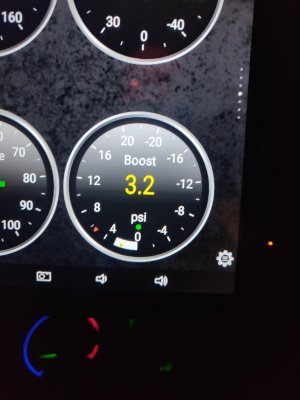

I looked at everything and saw no vaccum leaks, I might have to do smoke test tho. Even considering that , wouldn't vaccum leak make it run lean and not rich ?, Also of there would be a leak why would car hold vaccum at 39 as it should in fail safe mode ? , Also a huge detail I forgot to mention , car holds vaccum in limp mode but in normal mode shows boost at idle on vac gauge in torque app, that makes zero sense, why it's on boost at idle . Procharger boost gauge is at 0 at idle like it should be

That's almost like your Procharger bypass valve is stuck..closed. It should be showing -20 hg vac on idle.

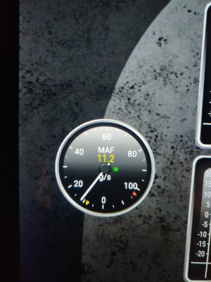

I mistyped badly in there ahhaah, it shows -26.9 of vaccum in limp mode , here are some pics of maf reading and other things with maf plugged so in regular mode at idle

What does Torque show with the maf sensor unplugged?
11+ G/second seems high for idle IIRC, Im assuming that is plugged in.
