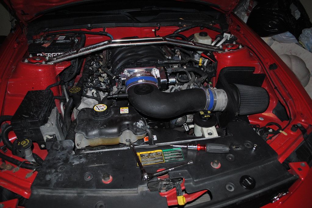

ok, so here's my first update:
just because a lot of you dont like the stash
he's using peanut butter in his car!?!?!?
THAT DOEST LOOK LIKE PEANUT BUTTER!!!!
stock heads. these are going to modular head shop on monday!
k-member and a arms
that will be the home of oil temp, fuel pressure, and boost gauges from ford racing in the future.
