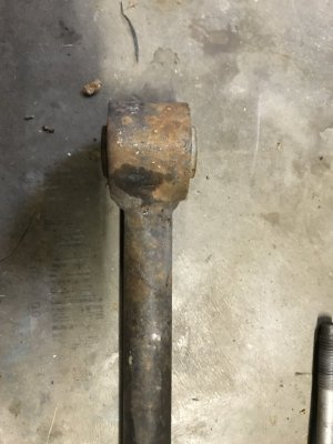

Hey guys. Brand new to the sight. I have a new to me 05 GT. I’ve put on new front and rear control arms, steering rack, steeda outer tie rods, and today a ford performance suspension handling pack with new front end links. My question - the Panhard bar in the rear had the bushings in line with the bar. The one I
Put on had the bushings offset from the center of the bar. Do these need to be aligned a certain way? They seemed to fit better when offset a certain way, but I want to be sure before I take for a drive. Thanks in advance.

Here is a picture of the new one and the one I removed from the car for reference. Thank you for your help

Offset in the direction along the mounting bolt axis would give you the opportunity to provide more PHB to differential cover clearance, in case you were considering changing that at some point in time.
It shouldn't matter otherwise.

Awesome. Thank you for your time and help. Much appreciated!
