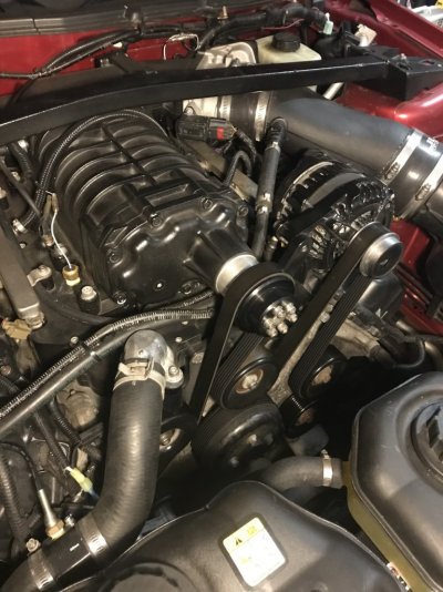

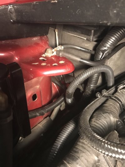

Yeah, I do. I used a 4 gauge 100% copper stranded cable which ran from a mounting bolt for the alternator and ran along the driver's side wiring loom for the head; and around the back of the engine to the passenger side strut ground point. I also added a small 10 gauge brown wire from a ground on the body of the alternator to the mounting bolt for the alternator. This ensures everything is grounded at the same potential. Your installation will probably be different (I have a DOB setup). Just ensure the major grounds run back to the strut tower and you should be fine.
