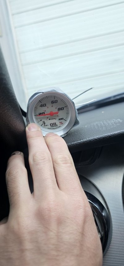

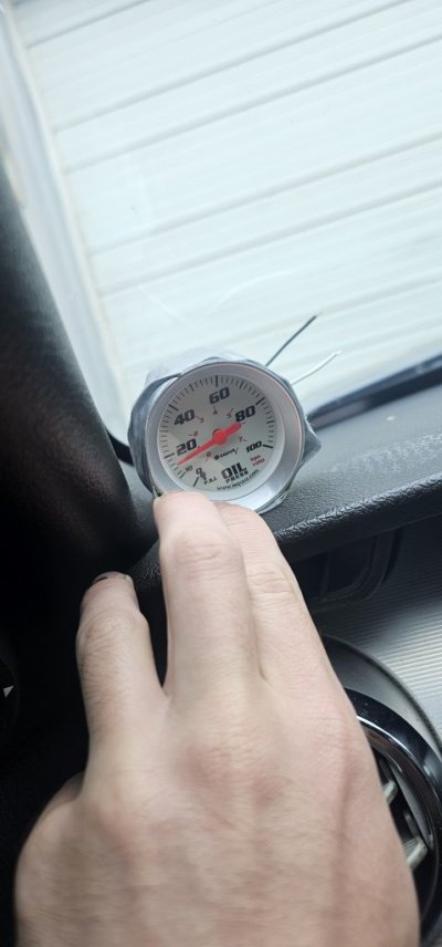

I have a 2006 gt that I just rebuilt the motor on. It has all new bearings, oil pump, hot rod cams, timing, new sending unit, ect. As well as a bore 20over. I put a mechanical guage tied in with the sending unit when i first got a low oil pressure light. When coming to a stop my oil pressure will drop to about 10-12 and under load idle at about 13-15. Now, it will only do this when the motor is hot. I am also currently running 10w30.
Prior to building the motor, I also had the low oil warning, but didn't hook up a mechanical guage then. I had the machine shop go through the heads and block as well.
Im currently at a loss because I cannot seem to make sense of why there is a loss of oil pressure only with those specific parameters. Any advice would be greatly appreciated.
The photos attached show oil pressure in park then in drive at idle.

If you had an oil pressure problem before the build: your rebuild didnt address the issue. Loss of hot oil pressure usually means too large bearing clearence.
lwarrior1016
Feb 11, 2023
208
126
mississippi
Too large of bearing clearance, not enough oil pump, or too thin of oil.
What are your bearing specs? What oil pump did you install?
What does the pressure go up to when driving? What is the cold start pressure?
StockishS197
Dec 24, 2024
434
378
Houston
When I checked mine a while back through the sending unit port, I had 30 PSI at hot idle at 850 RPM and would go above 60 PSI when increasing RPM to 2-3k. With 5w30.
If you just rebuilt, I would second looking over your bearing clearance.
