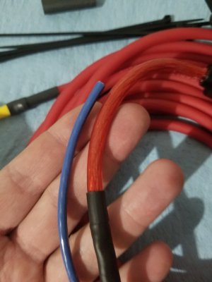

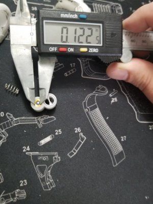

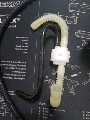

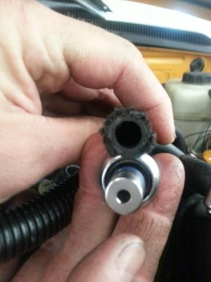

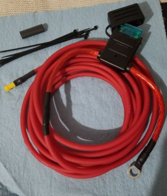

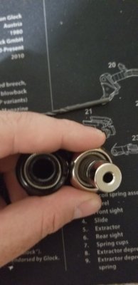

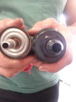

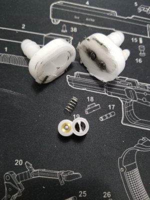

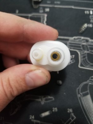

You can always add bigger pumps or voltage booster to increase flow potential. The overlooked things are proper wiring to minimize current draw and heat in the pump.(Hotter the pump runs the less it flows both bigger pumps and voltage booster increase current draw). And next overlooked part of the fuel system is the system that moves the fuel from the pump outlets up to the rails and injectors. (Ie. Plumbing on hat, oem fuel line, filter and connection to rail). We are doubling or tripling flow while still powering the pumps and moving the fuel through equipment designed for a 300hp na car. Less than efficient to say the least. There are large gains to be had here. These gains scale with flow hence why I always reccommend doing them first before just adding bigger pumps or voltage booster. A wire upgrade direct from battery to relay and fpdm feed, removing the pprv on the hat and a 8an line and high flow filter upgrade on the gt500 fuel system extends range and on average lowers duty cycle around 30%. That is pretty substantial and these supporting mods are pretty budget friendly, I make and test these kind of upgrades. Well worth it and always reccommend doing them first or in conjunction with more flow when your trying to support more hp and move more fuel.
JeremyH
3V Fuel Guru
Jan 10, 2009
20,857
197
Virginia Beach
Here are some pics showing some of these restrictions in the OEM system. Inside of the pprv, oem rail connection line size etc.
Waakeeen
Sep 13, 2019
79
8
Wow I’ve never seen them side by side like that! So let me ask you where can I buy such a kit, I’m about simplicity lol
