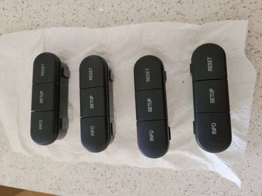

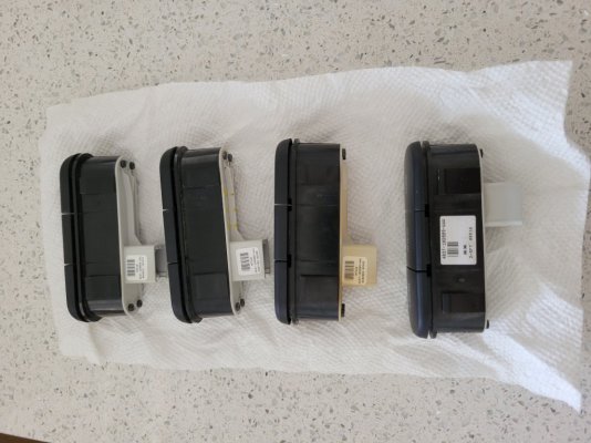

Also, the Driver Information Display Switch (6R3Z-18578-AA) seems to have vanished from the marketplace. Anyone have a good source for one?
DRW
Samos3
Feb 27, 2022
657
425
St. Louis
I may have an extra switch. As far as I know, the 4R and 6R are the same in looks and functional.
I typically get $35 shipped for them.

Many thanks to "Samos3" for selling me the buttons I needed! They arrived earlier than expected, plugged right in and worked as expected. I'll have to issue an official "Good Seller Alert" on him.
Now I just have to figure out how to get the oil pressure gauge to work. As previously mentioned, I suspect that the problem is the oil pressure sensor on the engine. (or lack thereof.....)
