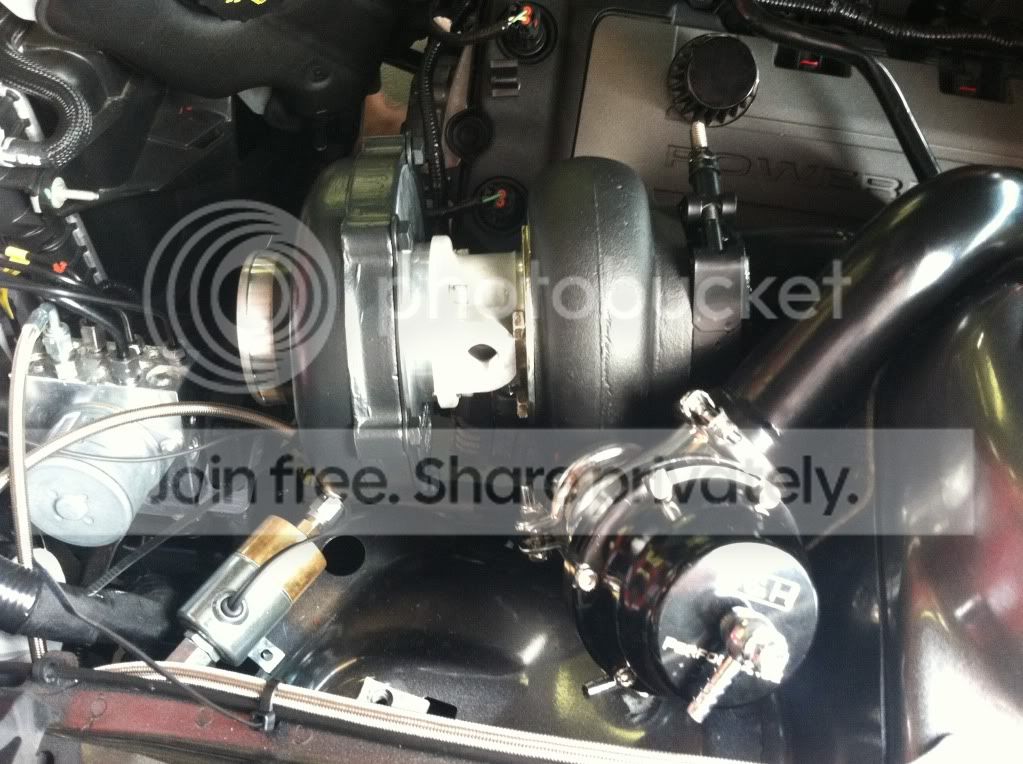

Sorry to hear about the issues, can't lie it does look damn good under the hood though.im sure there's plenty more power in it once the issue gets worked out.

May have been a nightmare but it sure looks awesome!!!!!!
Wow!!! Those under the hood shots are sweet. Now light the wick on it!!!!
