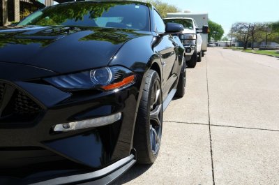

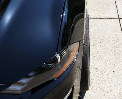

Love the wheels but the front offset seems way wrong.
Not sure why Ford saw the need for the front wheels/tires to be sticking out beyond the fender.
These cars are getting pelted with the rocks/stones picked up by those sticky tires, thrown all down the sides of the car.
Ford, this is not a great fitment:

Just a bit of neg camber would solve that asap. Or does it already have a bunch of camber dialed in ?

Seems like dedicated front fenders and lower bumper cover could fix that. Also make it more "exclusive".
But yeah, that is shit fitment IMO. Spend that kind of money then have shit thrown down the side of my car? And then have Ford deny warranty paint claim for a condition they created? Nope.

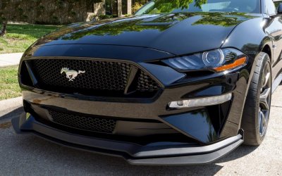

Doesn't seem to have much negative camber from the factory. Wheel sits pretty much vertical:
But supposedly there's like an inch of clearance on the inside, so why not make the offset so the wheel tucks a bit more?
Normally they have them in too much, now these are out too much. WTF.

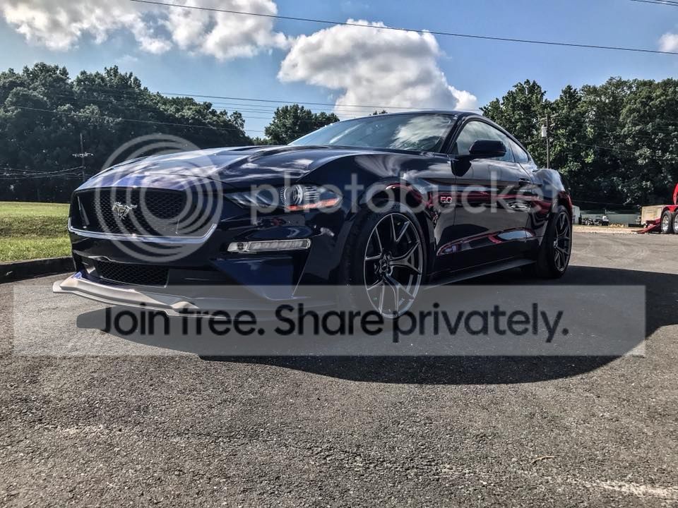

Larry03gt please post more pics of this! Thats the exact color I have been looking at for a PP2. Beautiful car man I love it. Congrats! Also your impressions on the car in and out.
Hahaha that's awesome! The performance pack 1 with magnaride felt damn good but I dont think it could do that. Plus your car has tires way beyond the PP1. That's just so pretty!
This is the only other pic I have right now. I need to go out and get some shots.
It's mostly a consequence of having 10.5" wide wheels and 305 rubber up front, with however much strut-side clearance Ford's corporate standards might require (I don't know how much clearance the PP2's have here either).

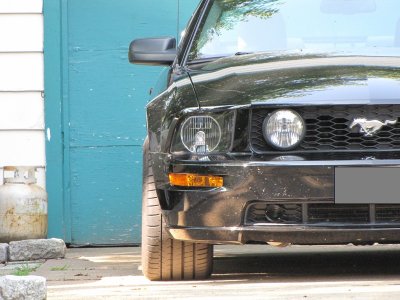

The PP2 is a car for the corner-carvers among us, not the drag racers or the Cars&Coffee crowd. When you start getting serious about enjoying roads that don't go straight, that's about when this look starts to look right because it is right for that usage. But it almost seems you actually have to be that serious.
Those are 18 x 11's, actually, and yes they're mostly for the track time the car sees.
Norm
Norm
A front 305 really needs to be on a 11.0 " wide rim..and preferably a 11.5" rim.
Norman forgot to mention he is using 285's up front... on 11" wide rims..so they are stretched pretty good.
Ford should have anticipated all of this, and simply made the front wheel flares slightly wider....problem solved. Even just 1/2" more..then dialed in some neg camber. As is, it appears from the pix, there is no neg camber. Too bad, they could solved both issues..in one shot.
Actual section width of a 285/35 MPSS is very close to 300 mm. Not all that much narrower than a 305 on its measuring width rim (which just happens to be 11").
I suppose they could have done the same thing that Chevy did with their 5th gen Z/28 and tightened the visual tire to fender gap a bit as a side benefit (for those who care about such things).
Norm
