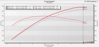

Lund is at it playing with their new 2020 GT500.
First pulley swap has it at 879 rwhp
Car already has upgraded injectors, and Lethal race exhaust pipes.

that's on E85 as well from what I saw

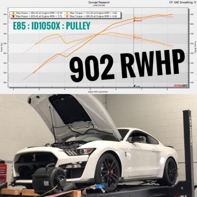

they just posted 902 whp 2.65" pulley

Seems they stopped with the 2.65 pulley:
"Well....Success! Sort of.. ran into a TCM torque limit of some kind for now (the orange graph is 2.65 pulley and torque reduction happened around 3500 rpm). 2.85 pulley made 879 with a little slip up top. The 2.65 peaked at 902 with a little belt slip (need a shorter belt) and probably would have hit 740-750 torque with no torque limit from the TCM. Once the TCM access is unlocked this should hopefully be remedied! Fuel system still seems to be holding! Probably will need a BAP or pumps changed above this boost level."
