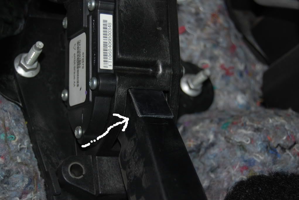

Most of the play in the pedal can be tuned out but there is some physical play that might still remain. A little lead tape on the arm will help as there may be some dead space at the beginning of the pedal travel.
That looks a whole lot less invasive and risky than disassembling the pedal sensor and tweaking the brushes. And the end result should be about the same (you would want to do the 'reset' procedure so that the ECU knows where "zero" and "100% WOT" are).
Norm
Yeah it is a lot less invasive and pretty darn easy for the less mechanically inclined. You do have to weight the pedal down pretty good while you apply the tape as that pedal comes up pretty quick when the paving stone you have on there shifts and the pedal smacks the back of your head slamming your face into the bottom of the dash. Just a safety tip from the more experienced.
Norm
Wouldn't the reset procedure negate the whole purpose of the mod? If the ECU knows the "pedal slack" has been taken up, it will acquire a new zero based on the new position. Or am I misunderstanding this?

I doubt that it can determine the new 'zero' without going through the procedure because the ECU only understands voltage input and would not know where the new zero really was at. In addition to the new voltage at 'zero', it may also need to be told what the new voltage range between the (new) zero and max positions is. It can't upset the mechanical mod, which only serves to eliminate any physical 'dead bands' at the beginnings of the resistance traces inside.
No, the pedal slack taken up is a physical, not electronic. But lets say you adjusted the pedal or brushes too far and you actually have voltage at zero pedal position. It will adjust that voltage to be zero on the pedal. When you do the pedal learning it takes the voltage at zero throttle and sets that as the bottom of the range.
