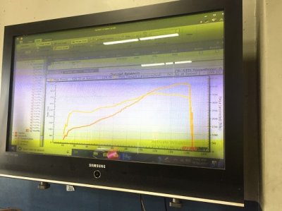

Just got back from getting some numbers on my GT turbo. Done at ISP in Beltsville MD.
Very happy with the numbers (actually we both were shocked) haha
Outside view
Inside view
Anyone have numbers from there Single turbo On3 kits?

What kind of dyno? And how big is the turbo? Transmission?
Can you post the graph?
I have a powerhouse kit and with a precision 6776 turbo it made 488rwhp at 6000 rpms and 442 ft lbs at around 5000 rpms on a dynojet. That was with a peak of 8.5 lbs of boost. Stock motor and charge motion delete plugs.
I have not had it back on the rack with the built motor (Cams, ported heads, s369SX-E turbo) but the car has picked up 11 mph in the 1/8 mile.

well i dont really know. trying to figure out the car. any help would be great

No they did not tune it. I wanted to see what power it would make. The A/F was not logged but in the 10's.

If your A/F was in the 10's, there is a lot of power to be had with a better tune.

IMO I would take it easy driving around until you get a custom tune, or at least data log what you got and send off for someone to look at. With your setup I would think you should be 480 to 490 to the tire with a good custom tune.

@ 9 psi? I think 450 is reasonable with a decent tune on 9 psi.
