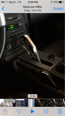

    Quick video of the shifts using Manutronic / Select Shift

    The TCI Outlaw is also an option for a shifter. It has the 2 buttons for manual shifting, the software will switch to manual mode when the shifter is pulled back 1 click from drive. Just FYI
