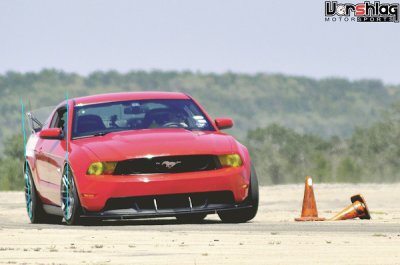

Admittedly, this is the most dramatic pic I could find of my whip. Slow right hander, power on so torque is twisting the axle, and downhill.
I have tons of pics of our S197 with "positive rear camber"... or what appears to be so. Its actually not - the solid axle isn't bending, the entire body is rolling relative to the axle.
That said, sure, a cambered rear axle would be better for handling. The problem is the EXTREME costs and high wear items involved. Its also usually banned in most racing classes.
Of course the axle isn't bending. But is it planted evenly on the ground? Heck no. It's going with the body, worst on slow right handlers when torque is also lifting the passenger side rear wheel.
Terry, I'm not looking at the body at all, or even its roll relative to the axle. Hell, all that red and white sheetmetal and all the sprung weight bolted to it could be invisible for all I care. There is no way that axle isn't "rolling" and putting a little +camber on the outside and a little -camber on the inside. Near-zero inside tire load and a couple thousand vertical lbs on the outside is somewhere around a 1" difference in vertical tire deflection, spread out over 62" or so. First cut approximation, I make that a little less than 1°, + on the outside, - on the inside. It's not an optical illusion.
You know as well as I do that the axle is not infinitely rigid, so it has to be bending some very tiny amount. But I'm willing to say that effect is negligible noise in the bigger matter here if you are.

Fortunately for us, it's easy to draw the lines showing the relative angle of the wheels. To draw the lines, I located the uppermost and lowermost points of each wheel, and drew the lines to intersect those points. When you do that, it becomes clear that the rear has positive camber relative to the front (click on the image to see the lines better):
Now, that could be because the car was going over an irregularity of some kind, but that doesn't appear to be the case here.
And assuming that the front's camber is optimized, it seems unlikely that the rear's would also be, based on the above.
