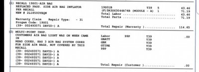

I recently purchased this Mustang and it came with a steady airbag light. The light flashes "23" when started. There was an airbag recall that needed completed on this Mustang, so it was assumed that this was the issue. I got the airbag recall done (passenger side front airbag was replaced; see attached). He ran the codes, but I don't believe he added the specific codes to the sheet. He said the airbag may or may not deploy in a crash. Either way, the drivers seat belt light does not come on, and "23" is the only code flashing. There are no engine codes on. These are factory seats, and to my knowledge, are original to the car. I checked the wiring underneath the seat, and all appears intact. I disconnected the yellow two pin connector (I'm under the impression based on internet queries that it may have caused it), but had no results, good or bad.
2007 Ford Mustang GT/CS
159,333 miles
4.6L, 5 speed manual
I'm trying to fix this myself, and can't find any good info online. Dealer wants one hour of pay to diagnose it, and I'm not willing to pay it. I am comfortable working on 12v wiring and have a good multimeter, but I have never worked on an airbag system so I'm out of my league, as of now. Screenshot_20200223-135324_Drive.jpg 20200223_134257.jpg

You do need a more capable scanner, the SnapOn scanner can read SRS modules I believe. IN that last photo you posted it looks like on of your airbag spots is being spoofed by a dummy resistor, that looks like a plug. Could be the wrong resistance.
