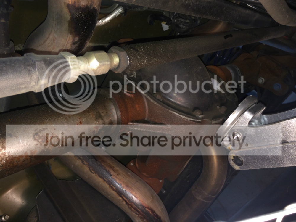

Well two years and about 12k miles later, same issue has appeared. The picture really doesn't do it justice for how much oil there is covering the axel tube.
IMG_2425_v2_zps522ee266.png~original
You can tell that it must have spewed out of the vent tube everywhere, including my exhaust and panhard bar. This cannot be normal. I'll be taking it back to the Ford dealer tomorrow morning. Curious to see if I am going to have to fight to have them pay for it due to it being out of warranty.
