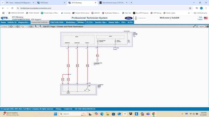

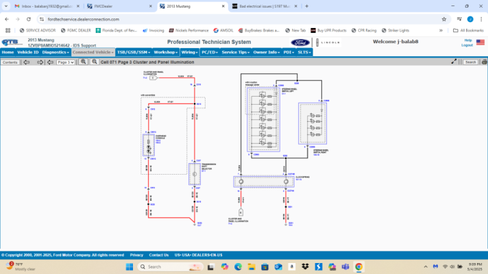

Does anyone have a pinout diagram from the IPC connector. I'm having an awfully hard time finding one
