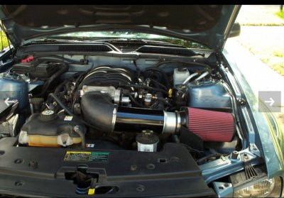

I have a JLT series 2 intake running with a custom tune. The old person I got the car from no longer had the tuner. On this Bama tuner, they list 3 different jlt intakes( serie 3, jlt 110, jlt ca). Can I use one of these with the series 2 intake

I believe the series 2 is the jlt 110
Thanks man. Also have one other question, so I'm running kooks headers and the only option is BBK listed under headers, would it Make a difference to use BBK if I have kooks ?

Only thing I've changed is the headers to kooks 1 5/8 headers and I've been running the stock tune with the series 2 jlt intake from the previous owner for a while now with no problems. So I should run the 3rd one then since it's not a series 3 and not 110mm ?
The tune from the previous owner for the JLT series 2 intake*

Found out series 2 is 89mm just like Thailand stated. Jlt support said use the 3rd tune "jlt Cai" and you'll be good to go.
