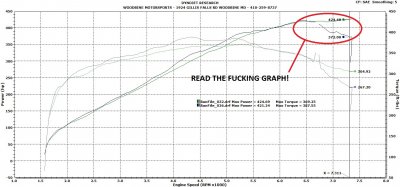

I am not going to argue with a imbecile such as yourself.
I had the balls to try something different and post results for the community. If you don't like it then feel free to decline participation.
BTW - I attached an edited dyno graph from WMS for your personal viewing pleasure.
**Feel free to not post in my threads again douche bag.** :thumb:
I have to agree with the guy who doesn't know a bolt on from a blower ;), that graph shows a big pick up of hp (50 on the upper end of the curve), but only a 3hp peak gain.

I think he just doesn't know what he is talking about. He thinks he can bolt it on and he will have 480 rwhp lol.
I re-read what you are saying and will admit I was looking at it from a different approach.
I understand what you are saying and you are correct it doesn't pickup "50whp". It sustains its peak and doesn't drop off like the stock intake.
My apologies.
So yes 480whp is out of the question however it will continue to pull to 7,500+ which will result in better track times.
