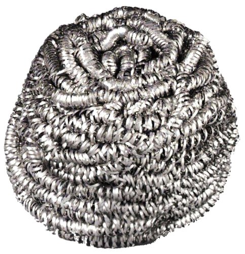

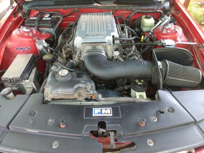

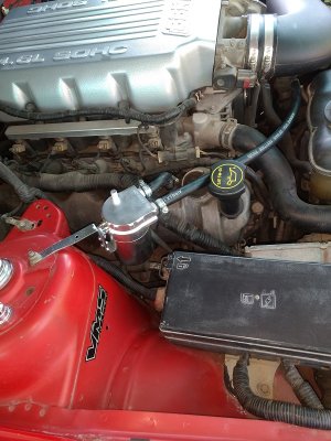

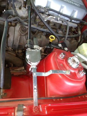

Just installed a pair of $25 billet aluminum Ebay catch cans yesterday. I inserted a Scotch Brite stainless steel scrubber inside each of them as a filter media, made custom mounting brackets, added lengths of 3/8" rubber hose on passenger side, plus lengths of 5/8" rubber hose on the driver's side. All went together very easily.

NO NO NO, do not use Scotch Brite pads! They will deteriorate, AND
where do you think those particles are going to end up? It may be
a little, but what do you use scotch brite pads for? SANDING...
Show us what you used, just in case. IF it's all steel mesh, that's
fine, but if it is an actual scotch brite pad, that's not good.
Why would you bracket to the strut tower when there is a perch
already there?

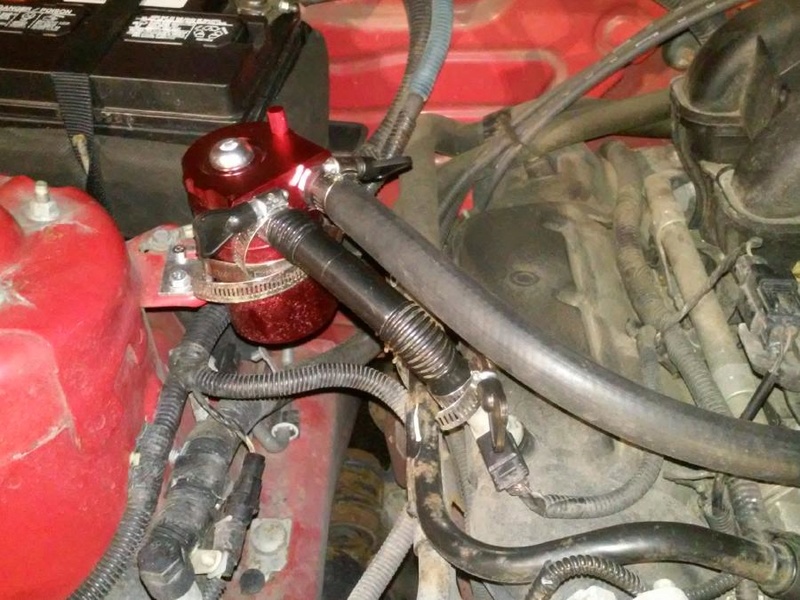

The RED one on the left... That's my trans-vent line catch. I had used that one for the
oil catch originally, perfect spot for one. Just saying... The mount is already there for you.
already there?
You're thinking of those green pads. I used the same stainless steel wool that you used.
I decided to fix the bracket to the passenger side strut tower 'cause that gave me the best angle to route the hoses from the catch can.

I had mine there:
Direct lines to the PCV and INTAKE, just longer than yours... But, as you can see above
I moved it to the intake plenum, and are using ^That for the Auto trans catch can.
I didn't think that they called steel wool, scotch brite pads... WE have green,
red, gray, and black, different grits... Use them to scuff plastics or metals
for paint prep.

Your V6 PCV and intake manifold vacuum port are on the passenger side so that arrangement is similar to what I have on the driver's side.
Sorry it's my fault for not making it clear from the outset that I used stainless steel scrubbers which I know to be safe. :) I've edited my original post to reflect that.
