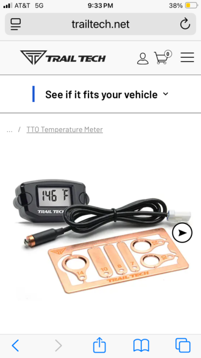

These TT gauges work great on motorcycles & I'm looking for a simple place to attach/insert a sensor & get approximate engine oil temps.

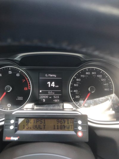

Try Scangauge. Plugs into OBD port and has numerous engine details. It will also clear common codes too.
I use one on my Audi and it reads everything I need… boost, temp, etc.

There is no oil temp sensor on the '05-'10s so nothing that plugs into the OBD port is going to help.
You can remove the OE oil pressure sensor (behind the oil filter), install a 1/4" NPT tee and then run a temp sensor along side it.

Contact scan gauge, and ask....
FYI It doesn't come with boost programmed but they sent me the code now my Audi reads boost. I don't like pods or gauges mounted in plain sight, so this little box works perfectly for my application.
