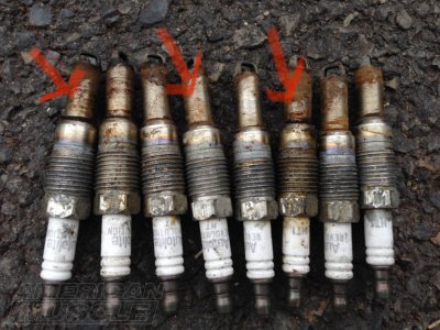

I did little research on the internet and it seems to me that everyone who had problem with fallen ground electrode have problem with combustion gas leak around spark plug too. So that make sense for me..
So I will use it anyway and check them after few hundred miles.
This is how looked every spark plug with failed ground electrode, what I found on internet. Corrosion and carbon build up, thru the thread:

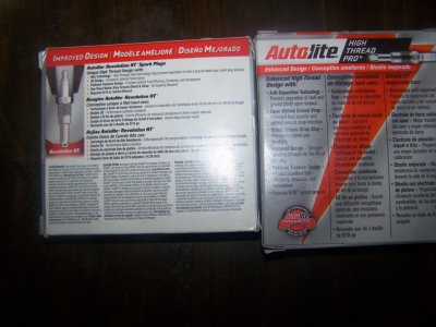

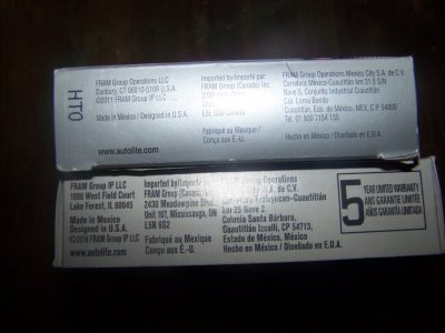

So how is it that I got the built in style from Brenspeed over 6 years ago on 10/3/14 if that revision wasn't even out back then? The welded on style were purchased from JDM engineering nearly 2 years ago on 7/1/19 Doesn't make any sense whatsoever! In fact, I kept my old HT0 plugs with the built in ground electrodes and the packaging for the current plugs with welded style. I'll be more than glad to take pictures and post them here to see for yourself. I also searched everywhere on the Autolite website and nothing came up for the Revolution HT plugs, but rather only the High Thread Pro plugs which have the welded style electrodes. All I can say, is if for whatever reason Autolite isn't acknowledging that the Revolution HT HT0 plugs are still in production? then you can be assured this will be my last set of Autolite spark plugs and will then make the switch over to Brisk Racing.
Anyhow here's a link attached from the Autolite website and package images for both my old Autolite HT0 and current High Thread Pro HT0 plugs.
https://www.aftermarketnews.com/autolite-introduces-improved-design-revolution-ht-spark-plugs/
https://www.autolite.com/products/spark-plugs/high-thread-pro/

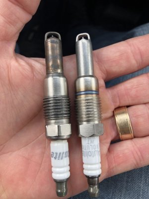

I uploaded the picture I took in January, with the old, welded style on the left that had been installed since August, and the new, integrated version purchased in January.
No! We're not talking old style heads vs new style. If you noticed the images attached of my old HT0 plugs? I have the old style heads (2005 through early 2008) just as you have. My old plugs are also the very same Revolution HT HT0 plugs as you currently have. I also attached the very same links in my previous post as you did, so this does in fact mean the revision change to the built in electrode design took place in 2011. Best way to find out for certain is to check the manufacture date on the packaging box that your spark plugs came in that you purchased from Advance Auto and if the manufacture date says 2011? then you'll know for sure the built in style are from the previous revision. I also hate to say this, but the Autolite link you attached is not from Autolite, but rather from an Autolite distributor. Here's another link from the very same source to prove it. https://www.autolitesparkplugs.com/about-us-autolite I also agree that it doesn't make sense that Advance would be selling the "old revision of plugs" but unfortunately their going to move whatever products remain on their shelves regardless if it's older or more recent stock. Like I said, check the manufacturer date on your spark plug packaging.
And I also really hate to say this, but the picture you uploaded that was taken in January with the welded style on the left that had been installed since August? is the current revision that first took place in 2016 which unfortunately has since reverted back to the welded in style electrode. The integrated version pictured on the right that you purchased in January, is the very same Autolite Revolution HT HT0 plug that I attached in my previous post was in fact purchased from Brenspeed over 6 years ago back on 10/3/14. The current revision is once again unfortunately the Autolite High Thread Pro spark plug in HT0. At any rate, I've also went ahead and attached photos of the manufacturing dates from the packaging for both the Autolite Revolution HT (2011) and Autolite High Thread Pro (2016) Anyhow, for what it's worth, pictures do not lie. The image on the top is the Revolution HT HT0 previous revision with (2011) date of manufacture and High Thread Pro current revision with (2016) date of manufacture.
