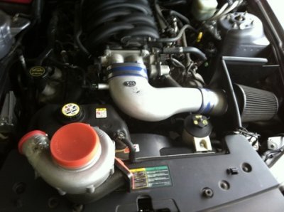

I actually don't think it's a boost bros turbo. But one from relentless performance. They bought out boost brothers apparently. Here's a pic of it

Master power seems to be a cheap entry level turbo that does good.
They just dont perform good. They arent spooling up till around 4500-5000rpms.
Dont be fooled, relentless perfromance is boost brothers!
They changed their name because their turbo kits had such a bad rap! lol
Funniest thing is it actually worked for them.
Best of luck to you and your engine.

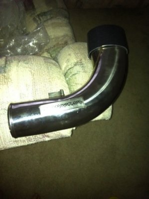

Lito this is the Maf housing on the intake same as turbonetics.

havent started the install yet but glad to say we dumped the bb turbo and are awaiting the 67mm precision from lightblade. Lito said he can tune it once its installed so i may go with him or this new guy i found here at BoltonPerformance in Arkansas. I believe its the same guy that tuned Abdullagt's
