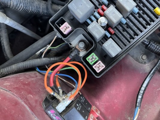

This is my relay setup. I’ll have to take the fuse box out to find wire locations I cut.
Picture 1: the large blue and green are going TO the fan. High and low power.

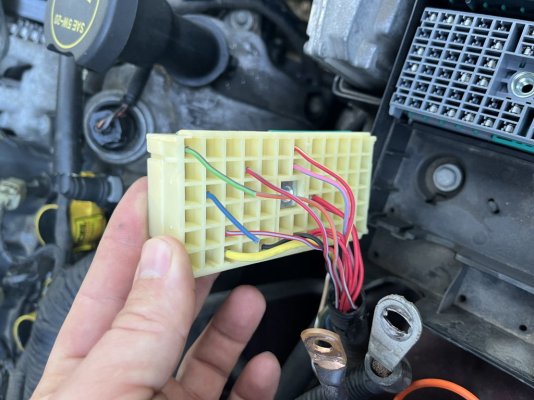

Picture 2: large red wire goes to the battery stud on the fuse box, it needs to be a large gauge. Orange loops battery power back to the relay. The small blue and green are the ground triggers from the computer to turn the relay on like stock.

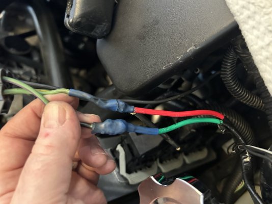

Picture 3: Again, the ground triggers blue and green from the computer. The brown wire is for my EPAS rack. View attachment 99900

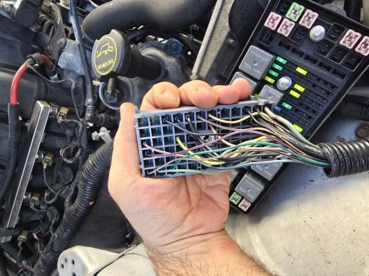

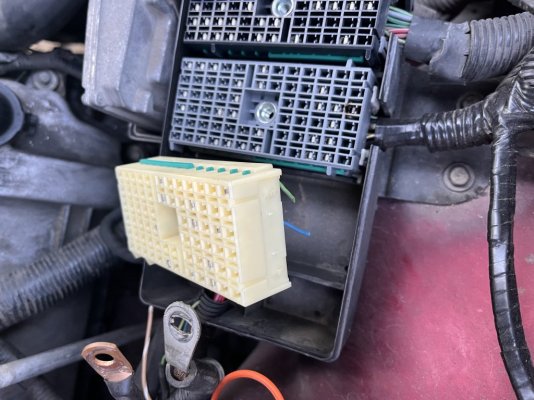

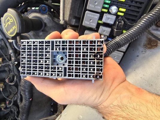

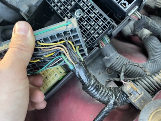

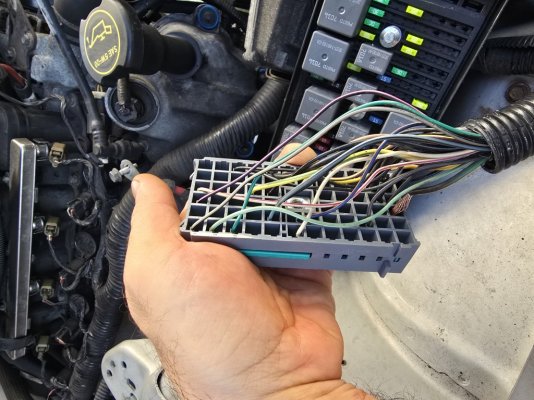

Got you a couple pictures, it’s the best I could get without pulling the tape back. If you need me to open the harness up, I will.
Your signal wires are the two small wires in the white connector. Those are going to ground trigger your relays.
Then the large wires from the fan relays out to the fan are the ones you’ll cut and send over to the new relay output. One of them is going to be the burnt wire. They are in the grey connector.
View attachment 100380View attachment 100381
And then this is where my power supply wire goes. View attachment 100382
I just want to get the right wires correct.The large wires in your picture are green/yellow and green/purple coming from the gray connector? and the green and blue wire coming from the white connector are the ground/trigger wires?

Yes, that is correct. It looks like yours has burnt the low speed and high speed out. Good grief.
